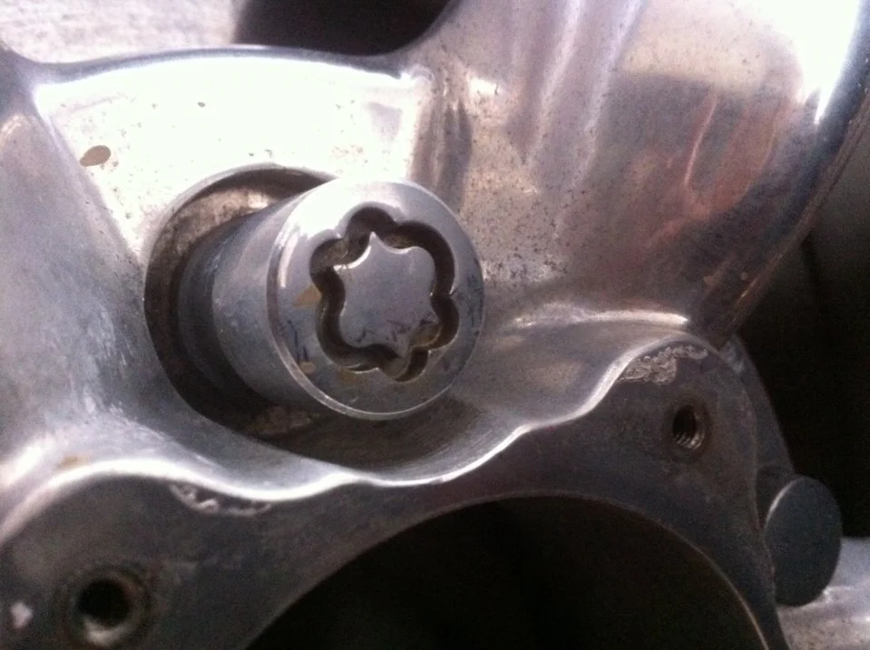

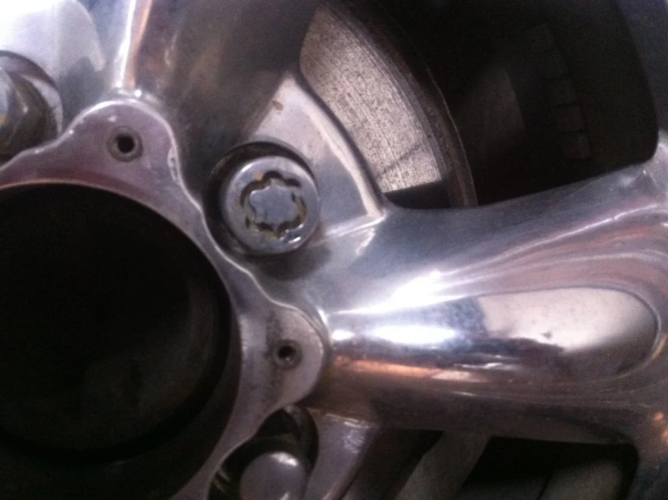

94coupe 15 Year Member Oct 6, 2013 138 0 17 Calgary ab Apr 9, 2015 #1 Apr 9, 2015 #1 Anyone have ideas for getting puzzle locks of my American racing wheels? No clearance for extractor??shop wants 400 to drill them out Thanks Attachments image.webp 64.3 KB · Views: 186 image.webp 52 KB · Views: 220
trombonedemon Well-Known Member Jun 25, 2009 1,962 39 59 U.S.A, U.S.A., U.S.A.! Apr 12, 2015 #2 Apr 12, 2015 #2 I would get a sawzill, cut a deep groove into it and find the most sturdiest screwdriver from Lowes or Home Depot.
mransr Founding Member Nov 3, 2000 1,188 36 98 Riverside, SoCal Apr 13, 2015 #3 Apr 13, 2015 #3 stop by a muffler shop and have them weld a nut to the end of the lock lugs. Reactions: trombonedemon
