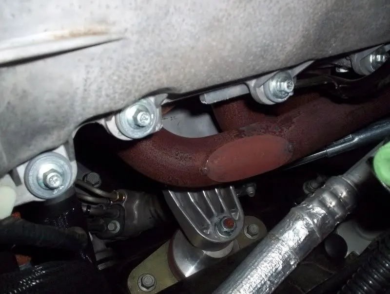

different grades of stainless have different corrosion resistence. between 409 304, one is better than the other. i dont recall which is which though. there was a big debate a while back about some stainless headers rusting. they wont rust through, but they can get some cosmetic rust.

here is a pic of the stainless headers in question....

With respect, that's not related to drilling a hole causing faster rusting. T-409 SS is stronger/more durable due to some other alloys being added (more chromium, some titanium) but T-304 SS has much better corrosion resistance. It appears most OEMs use T409 for factory exhaust systems, so they tend to develop surface rust after a few years but some polishing/sanding will make it shine right up. The S197 GT's stock factory tips are polished T304 SS while the mufflers, pipes, and cats are just T409. T304 will change color at high temperatures though.
Now I'm wondering why drilling a hole into an alloy is going to cause it to rust faster since it's not coated in the first place. I can understand drilling a hole into aluminized steel would accelerate rust unless the drilled portion is coated with paint, since the aluminized material is just a coating.
Another interesting thing I noticed is that since T304 isn't magnetic (not enough iron??), then it'd be more difficult to develop rust (Ferrous oxide) as we know it.

all is theoretical, thats for sure. i dont have concrete proof one way or the other. those JBA headers were fairly new, IIRC.
a polished surface will have greater resistence to corrosion when compared to a non polished surface. the polished surface has less surface are for corrosion to start. a surface thats a little jagged, like if it was sanded with course sandpaper, grinder, or a not so sharp drill bit, will have more surface are for problems to start.
i do see your point. stainless is different than regular steel (in a good way, thats why it is used). i dont have any experience with stainless and corrosion, so these are theories. Darkfire, if you feel comfortable, then try it out. are the pypes 304 or 409?

You make an interesting point about the surfaces. I wonder what would happen if you had polished those stainless headers? I painted my Mustang GT's factory exhaust with black rustoleum for extra corrosion protection. I know its T409 but what the heck...
