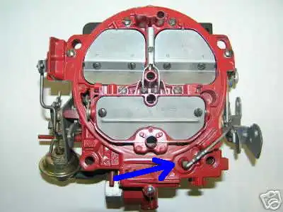

I have a Rochester Quadrajet that recently started to leak fuel all over the engine. The engine has previously run fine with a few hundred hours on it. Upon inspection, this fuel leakage/overflow is emanating from the point where the accelerator pump piston passes through the top of the carb body. (Please see the blue arrow, and oh yeah, this pic is of a Quadrajet, but I took it from off the net, and it's not a pic of the actual carb in question). This happens 5-10 seconds from startup.

I can't tell you what's wrong, but if it free flows fuel all over the engine, it's not a certified carb for a marine application. Could get you a ticket if it's ever inspected. Oh, and Ford DID use Quadrajets in a few applications in the early 70's on 351C's and 429/460's.
sounds like the accellerator pump bore is worn and has a groove in it. run your fingernail across the bore and if it catches you have a signifigant ridge. you might be able to smooth the bore with some very fine sandpaper, but more than likely you're going to have to replace the carb. edelbrock makes a decently priced marine certified carb as an FYI
qj's are excellent carbs as long as they work right, but when they start having problems, almost always wear related, they're junk. if the the accelerator bore is actually worn badly you'll probably find the throttle shaft bores are worn just as badly and that is an expensive fix, you have to find a carb shop that has the right tools to ream it oversize and install a bushing kit. finding a good carb shop that can actually do it is getting harder to all the time
