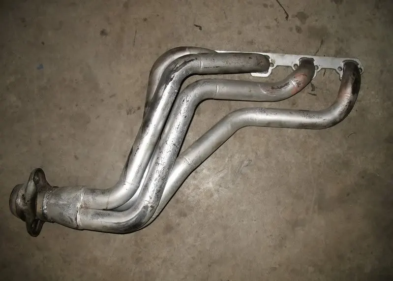

I have a 67 Fastback w/ a 4spd. I have a funky set of headers on it. They were on the car when I bought many years ago. The driver side are in 3 pieces to go around the clutch assembly. They weird thing is that after the clutch assembly all the tubes line up and the other 2 pieces of the header bolt up to it (any idea what they are?) I had a make a custom gasket for it and it held up for a long time. That was until yesterday. I was going for a drive after an oil change since I am storing it today for the winter and it blew out the gasket.

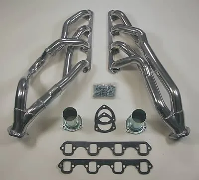

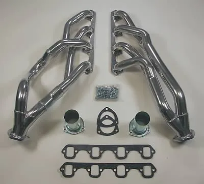

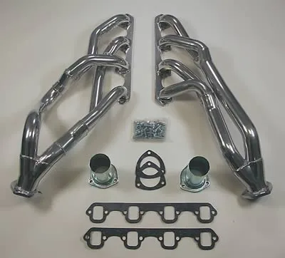

I'm sending some Doug's headers to Jet Hot and as I recall the quote is $280 for the Sterling treatment. I went with Jet Hot because they coat inside and out. They also claim to make a longer lasting product than any of the copycats. I ordered my headers "bare" so I could test fit them and see if they needed any work with the Chevy wrench to make them fit. They did not. In fact these headers are unbelieveably custom formed to fit the '65-'66, although I am using a hydraulic throwout bearing so I don't know how they will work with a Z-bar. Here's a pic:
The pic is the coated option, which goes for $530 at Summit. The bare ones are $390. (Yeah, that's right, I'll be having $670 in my headers when I'm done. :( )

Those are nice and look like they could work with a Z-bar. A bit spendy though. I know that you get what you pay for..

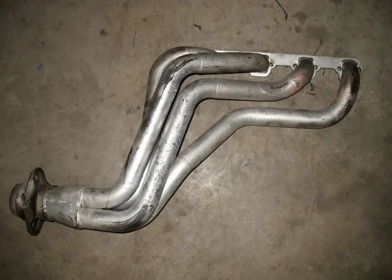

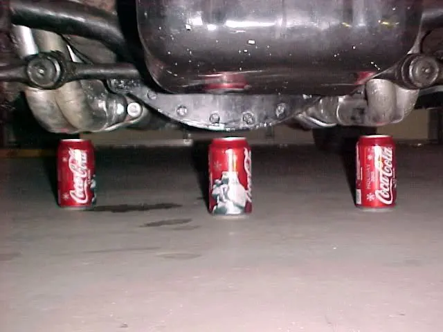

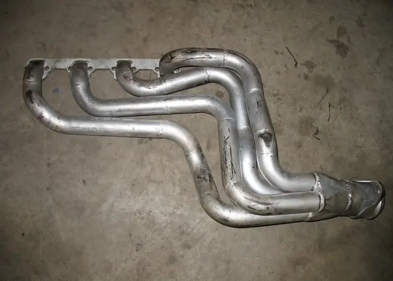

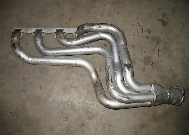

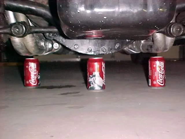

Here are a few pics of mine which uses 1 3/4" tubes. This is an older set that have not been coated:
I never had clearance issues with 6901s...:shrug:
Other headers, yes...
My car is lowered about an inch, the Lakewood bell and Moroso pan hung lower than the headers.
I admit though, really aggressive speed bumps and aggressive driving don't mix with just about any header! ;)
