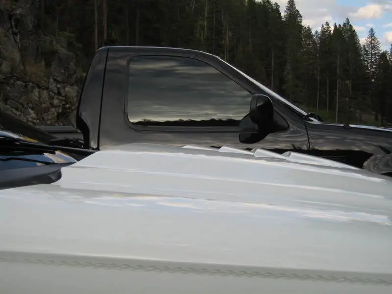

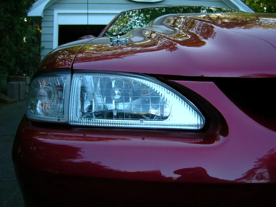

I have their cobra RR hood, and it does look nice, but it was somewhat of a pain to get to fit. I had to use fender washers under all 4 of the hinge holes to raise the hood up enough to sit flush with the fenders. I also had to grind down part of the inside of the hood where it sits over the edge of the headlight housing because it was contacting. It took a few hours of work, and it looks decent, but i know where all the blemishes are. I mean i cant complain, i got it for $200 used and its way better than the stocker. If i were to do it over, and i had the money, id probably buy a cervinis, but money was an issue because i was trying to get the car back together on a limited budget. That being said, if you get a good deal on a used one, and are willing to put a few hours into making it near perfect, then go for it, but for the $80 difference or so between the ABC new and the cervinis new, id get the cervinis. Just my 2 cents....
Heres a pic of mine. You can see where it doesnt sit perfectly where he drivers fender and the hood meet right over the headlight. The hood sits slightly lower.

Ouch... that's a ways off. How does it look at the cowl? I was thinking of going this route if my 96 Cobra hood won't fit over the new 331. :(

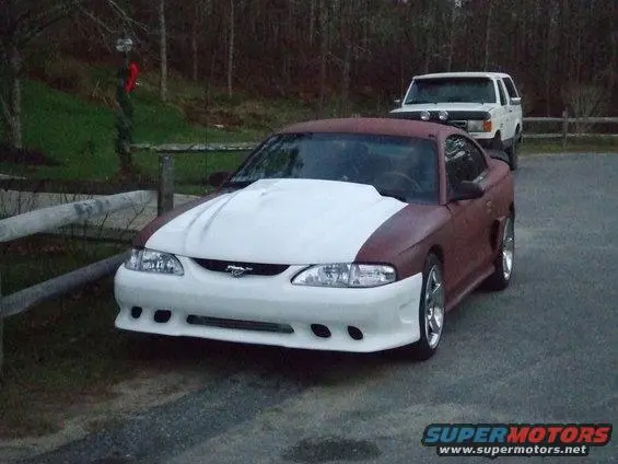

its wierd, cause it lines up perfectly on the other side, and along the fenders, and even at the cowl...its not put on crooked, its just a flaw in the mold i guess...or the previous owner of the hood may have sanded it down a bit to get it to fit with his fenders which may have been lined up differently than mine....
See its pretty much perfect on the other side...

How does it look at the other end of the hood up by the cowl? I would have had to measure each side of the hood to see what was going on. I wonder how much the fender would have to be compromised to help it. Sigh... good price on it though.

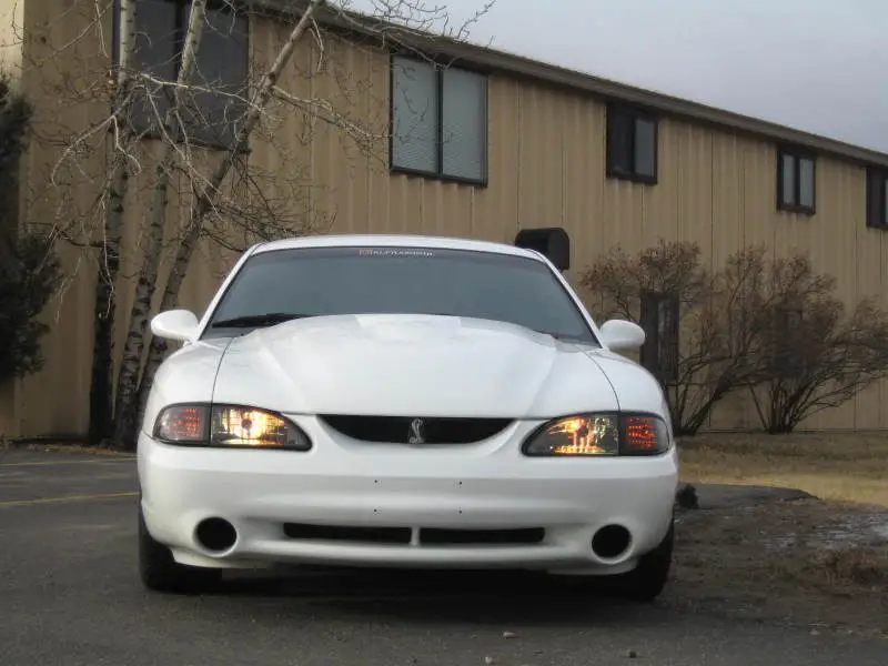

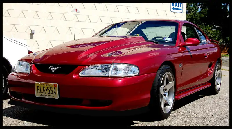

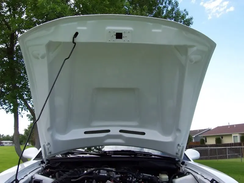

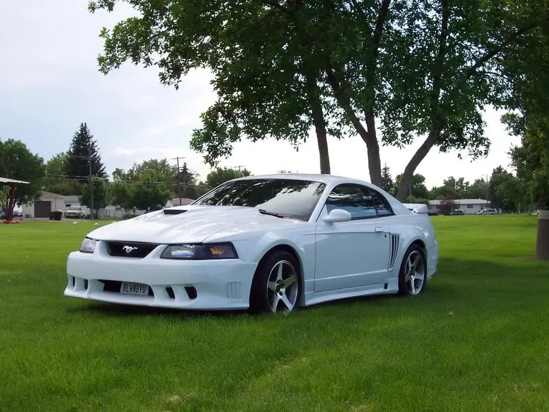

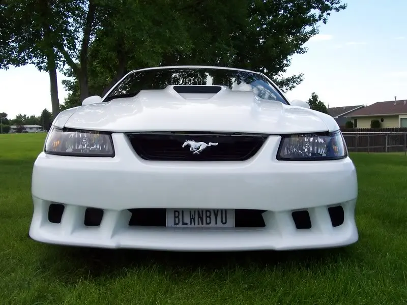

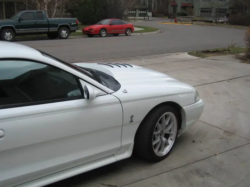

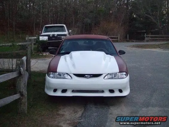

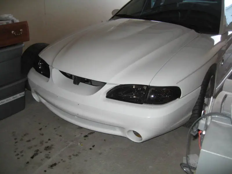

Cervinis is far better, but here's my abc...
Cervini's
