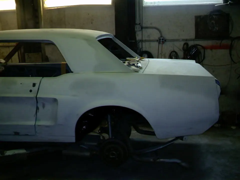

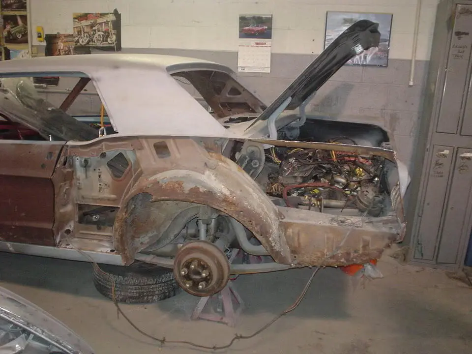

Here's what I started with :
New panel attached and primed:

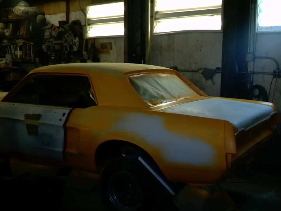

Panel jammed:

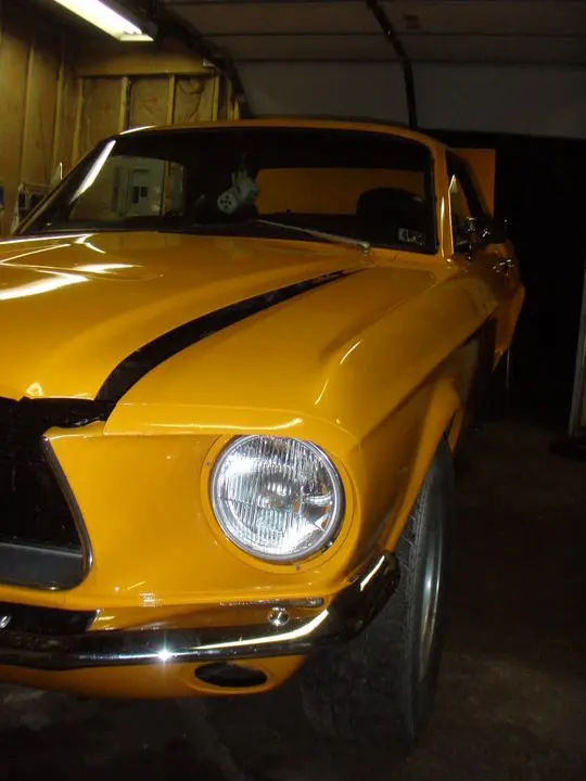

Car painted, sorry I don't have a finished picture of the quarter panel right now.

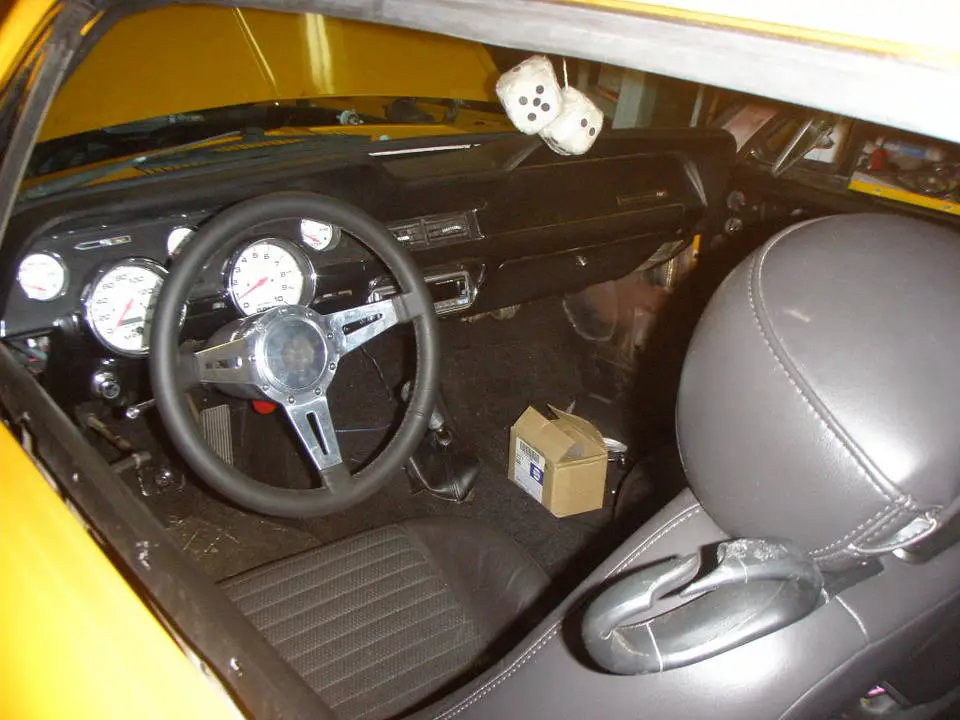

Interior, not finished but driveable:
Paint color is 2007 Mustang Grabber Orange
