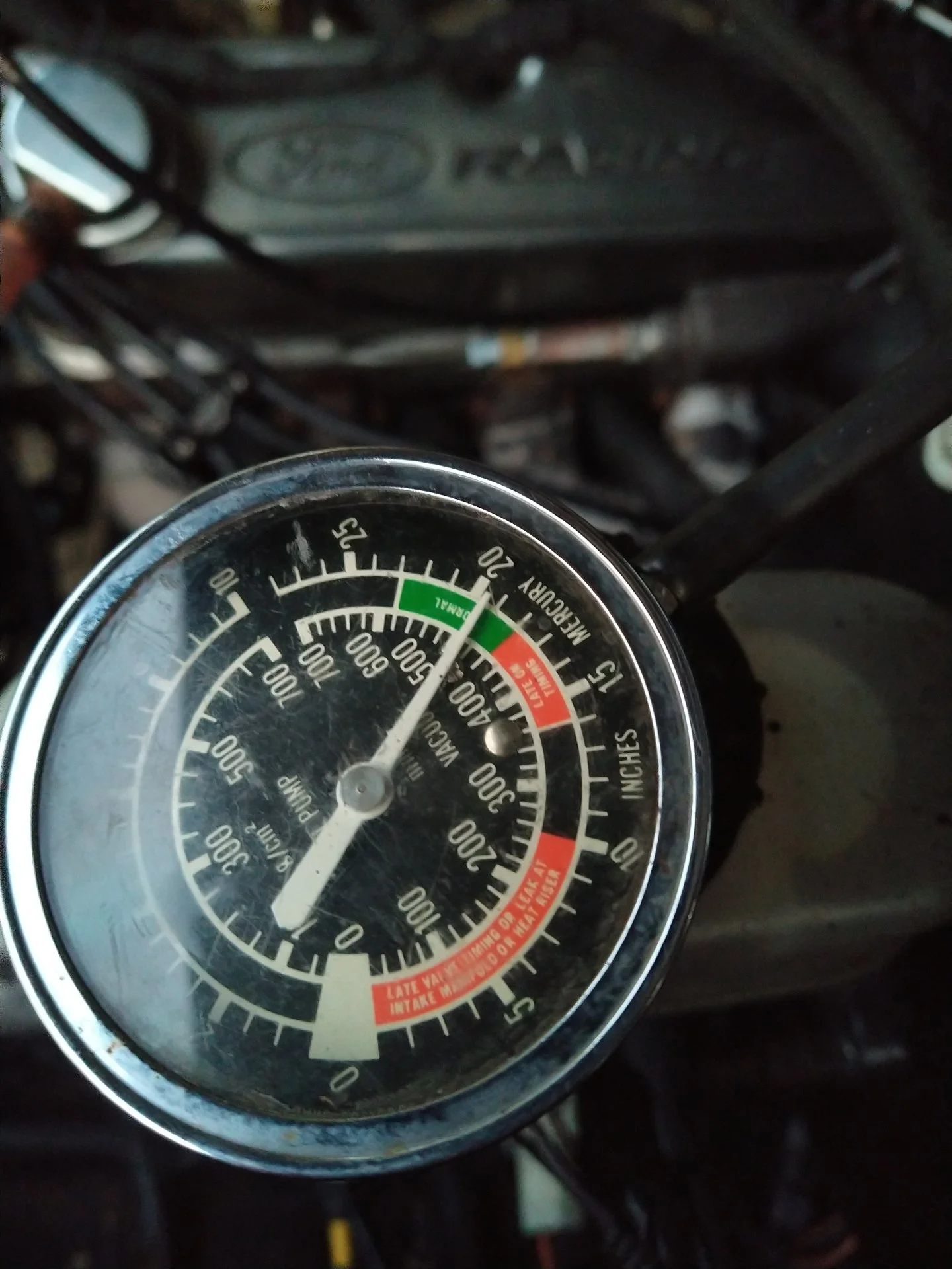

Do you have a vacuum gauge?...Its the best tool when you have a carb because you get the best vacuum with the best tuning.......
