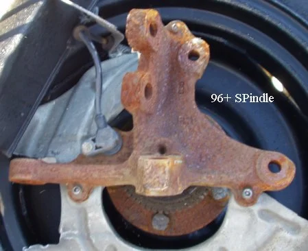

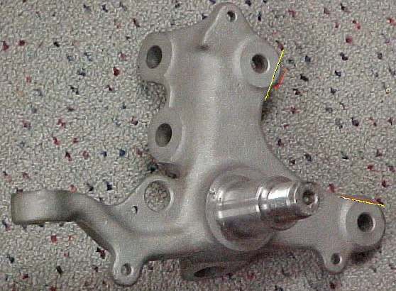

i dont know why that would be
Tie rods needs to be parrallel with the ground, same with the control arms
VS. this
Notice how the tie rods ends CANT be level
VS. this
Yes, the 96-04 spindles have that SLIGHT twist where the tie rod slips through. You gotta watch though. I've been through several pairs of those spindles and a lot of them were bent. I had 5 pairs sitting on the counter and all of them had different twists to them. I used a pair that had the least amount of it. But, the arm itself is straight. The 94-95 spindles arm is turned upward then flat. That is what makes the tie rod (inner and outer) go upward and out of parellel with the ground and control arm.

I'm not talking about the twist, im talking about the actualy level of the arm itself. Notice how the 95 moves up and the 96+ is straight. Thats what makes the difference, either way bumpsteer kits really do need to be used in both applications.
