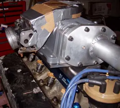

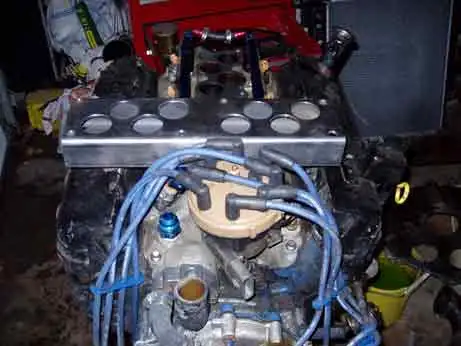

As for mounting the blower, I have a custom manifold made up.
Hold on, let me see if I can get some pics.
Ok... pics of the blower
I hope they show up......
