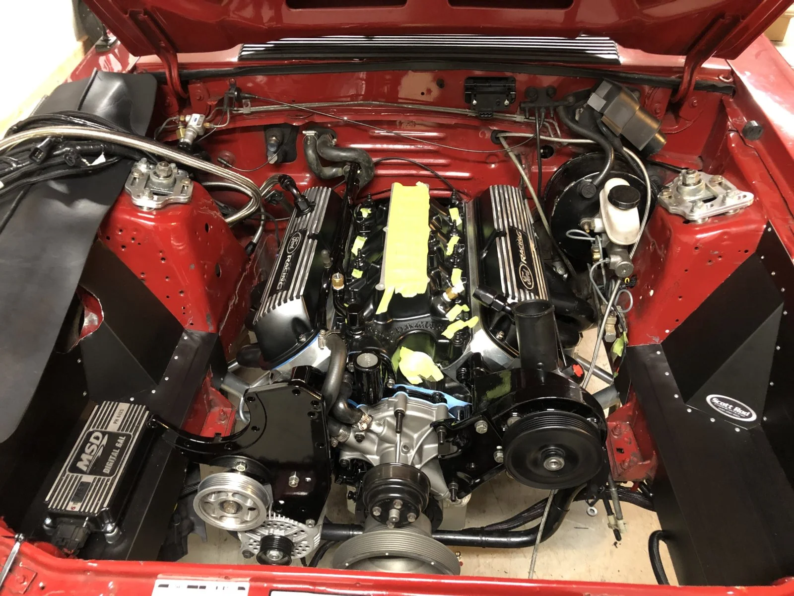

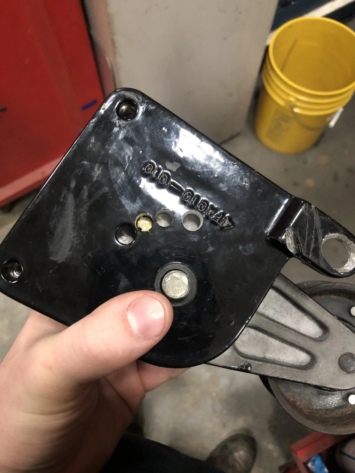

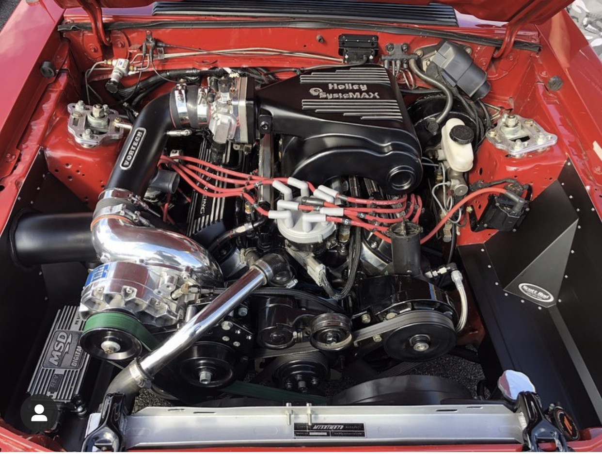

93 cobra water pump pulley. Grind the pin or do what I did and sscribe it and move the tensioner hole one slot up . You need a smog delete pulley with the blower bracket or the belt will hit the bracket bolts and support. I have a renegade bracket now but had the standard in the past . Just did the factory ac delete setup . Belt is 80.5 and tight you have to jump it on but this the way to make it happen . You see what I did on the tensioner I was testing what worked . You want a hole closest to the original as possible

Nope a little tricky to figure out at first but after talking to the right people what I gave you works . Most guys shy away from the factory ac delete like I did for a long time Cuz is this . Not having another idler really cleans things up
