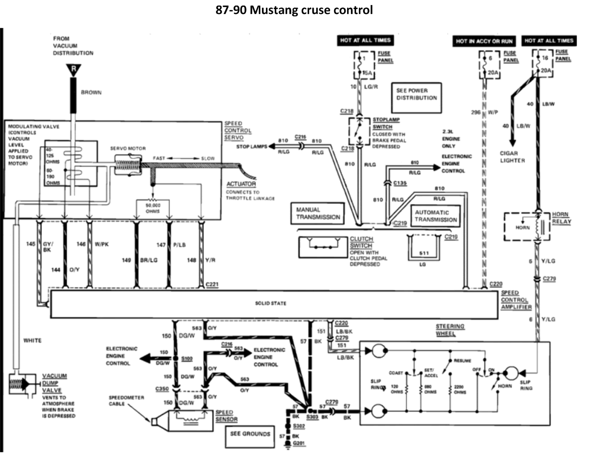

The diagram says 87-90 Mustang, but the 91-93 Mustang will be similar. The wire colors will be different, but the rest should be the same.
cruse-control-87-90-mustang-gif.583332
Speed control amplifier – located on driver’s side under dash between the steering column and the inner body panel
Check to see if the vacuum dump valve on the brake pedal is present and working – it has 1 vacuum lie attached and may a have a threated plastic housing and a yellow plunger actuated by the brake pedal arm. It is a tight slip fit in the mount and can be adjusted with some pushing or tugging.
