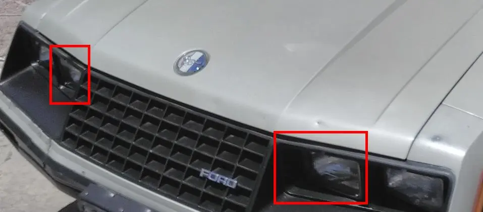

I'm still new to the 1981 Mustang and the previous owner I got it from wasn't completely familiar with the dashboard either (though he explained some controls to me out of trial and error but I forgot about a few now). I couldn't acquire a manual yet so I have some questions about the headlights switch and other lights:
How do I turn these on? (pic)
Pulling the switch backwards once turns the other headlights on, pulling it backwards a second time makes them brighter (I think), but Idk how to turn on those in the middle. I'm almost sure I've seen them turned on when I test drove the car before buying it though.

Those center lights are high beams and come on with the turn signal stalk. Pull back to flash and push forward to have high beams stay on. ( at least that's how it was on my 84 )
Older Fords had a metal button on the floor by your left foot toe. You'd press the button with your foot to cut high beams on ( my 89 econoline van has it ).
