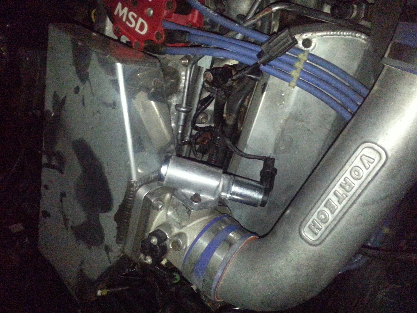

So my car has had some issues since I got it. After sitting for a few hours I have to give it gas for a few minutes to keep it running otherwise the RPM's will drop <700 and it will die. I took it into the shop and the mechanic replaced the Idle Air Control valve with a stock one. This didn't fix the problem and I think it may be the Mass Airflow Sensor. It has a stock sensor but is running 30lb injectors and a V1 Supercharger. I called the mechanic and he told me it would need a different IAC because of the charger but that sounds like BS to me. He was recommended by my dad but I am not impressed. Anyway, I can see the sensor and it would be easy to replace I just need to know which MAF sensor I need to get. And also will I need a different IAC valve because of the SC?

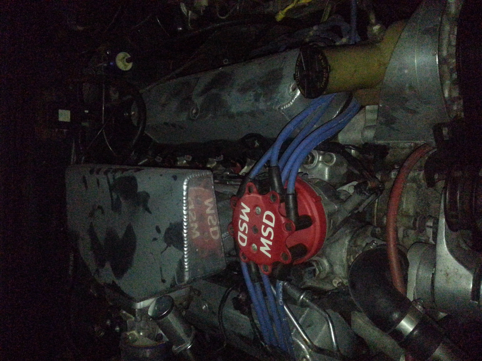

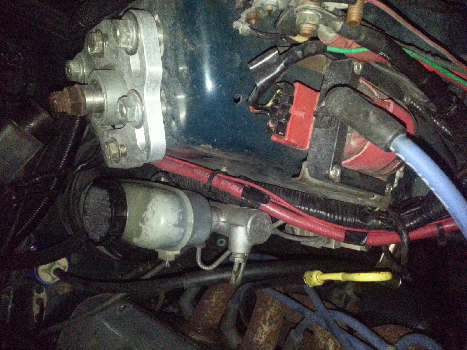

Take some pictures under the hood area and post them. Do you have a FMU? If so, most likely no chip or tune.

It has a check engine light. 93 lx hatchback. I'm in Cookeville, TN. There is a sticker on the back for East tn mustangs but Google is silent on them. I can post pics tomorrow. It has a ton of mods.

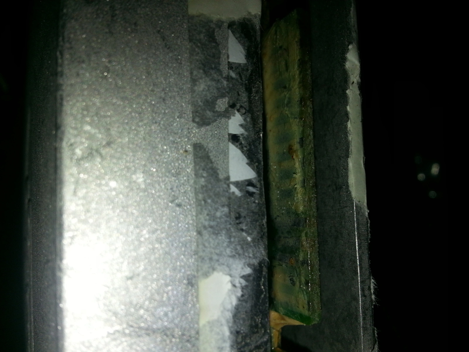

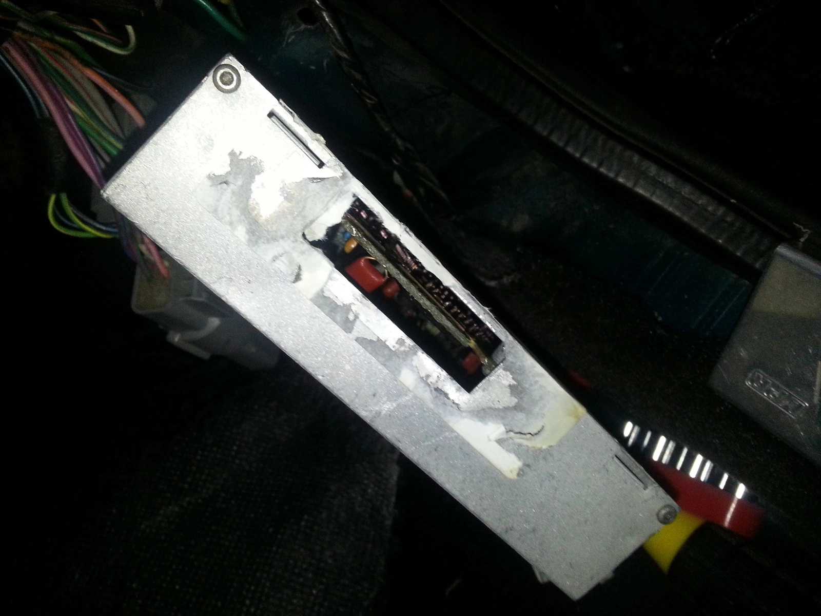

Pull your passenger kick panel off. Look for the computer and look at the end opposite the harness connector. There is a piece of tape that would cover a plug in port. Is there a chip plugged into the computer here?
Computer
Possibly dielectric grease.
Looks like there was a chip installed at one point, possibly a custom tune. It's been removed however. Can only speculate why.

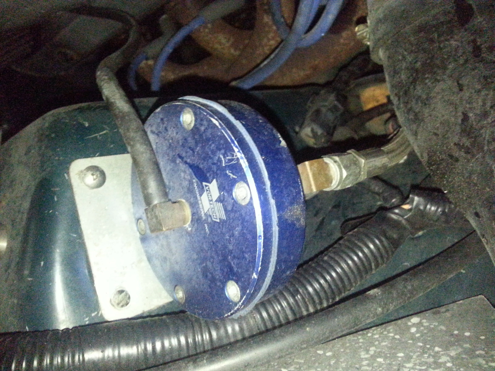

Are you sure the MAF is bone stock? Is there an FMU installed in the engine bay? It will look like a round disk.

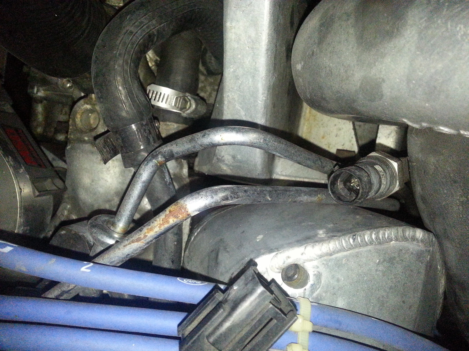

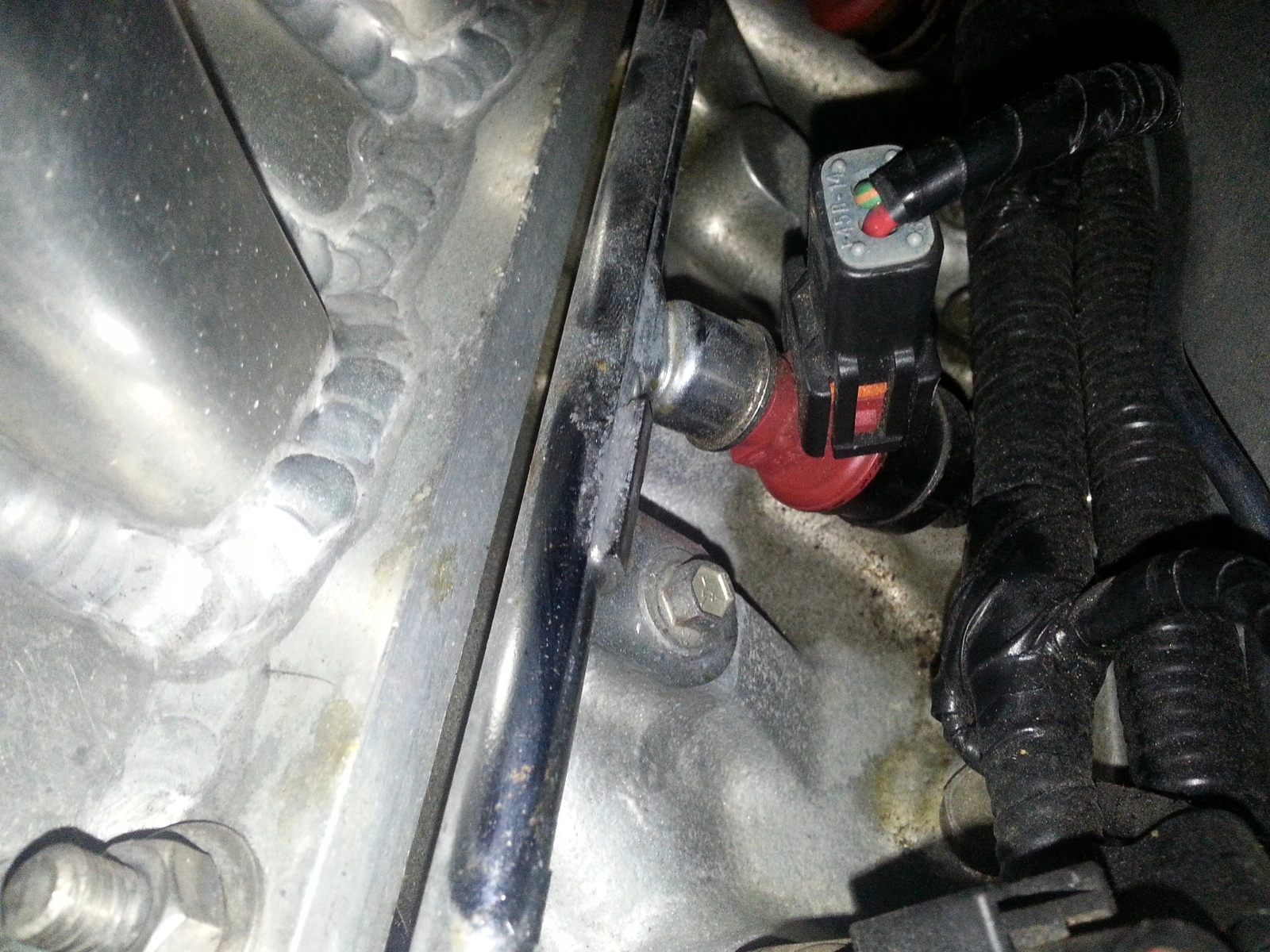

I didn't take a pic of the MAF because the numbers tell me it's stock and 55mm. I know it's wrong. But I don't know what I need to do about it. I put up a picture of the injector. It looks red to me and that would mean it's a 30lbs. I put up a picture of the computer and the FMU. I'm unclear how the computer/FMU combination works with bigger injectors.
Here's some info on the FMU
http://www.vortechsuperchargers.com/page.php?id=30031
