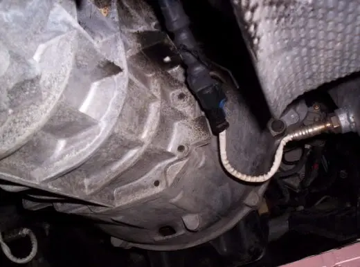

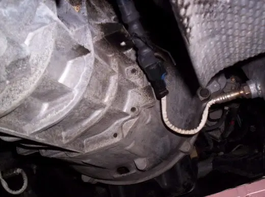

the MIL eliminators go inline with the rear O2 sensors. just unplug the O2s, then plug the MIL eliminators into that connector, then reconnect to the main harness.
you leave the upper O2 sensor on the passenger side alone. just plug it in like normal.

Sweet, thanks a lot man. So all in all, just leave the first hole on the passanger side alone, and the other 2 holes recieve the MIL elim? Awesome.

yes, just the lower 2 near the tranny. the front one on the passenger side is just like normal. you removed the cats, and these sensors are behind the cats. thats why you need the MIL eliminators.
