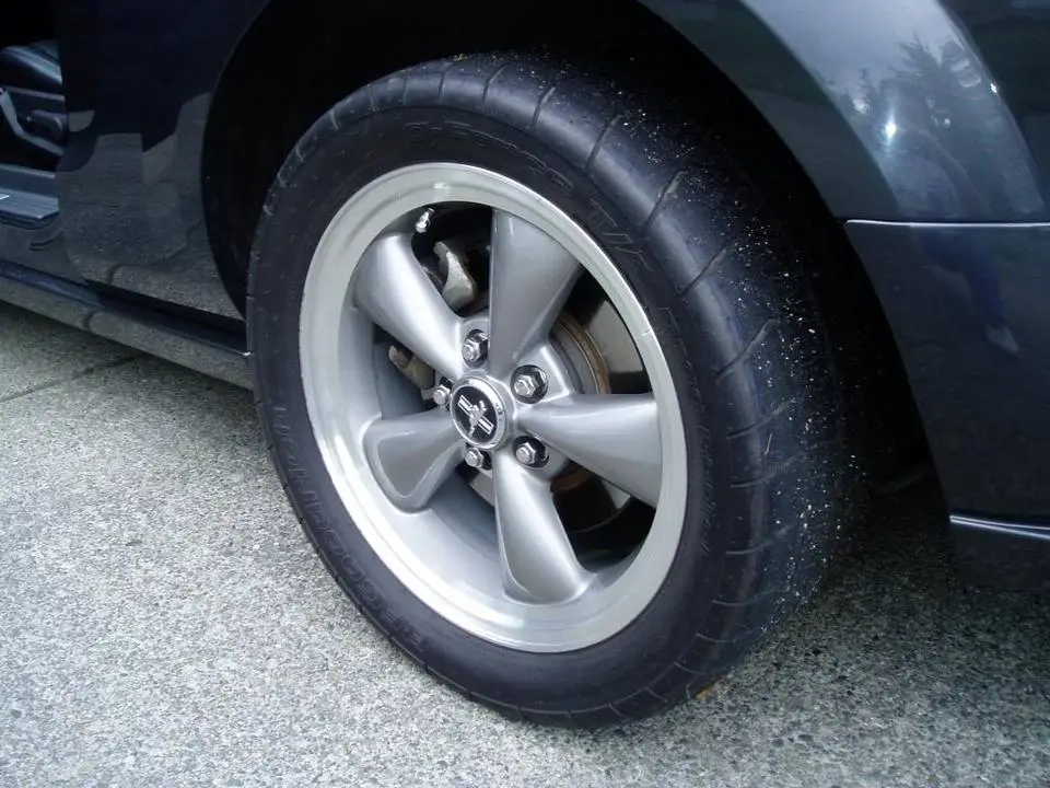

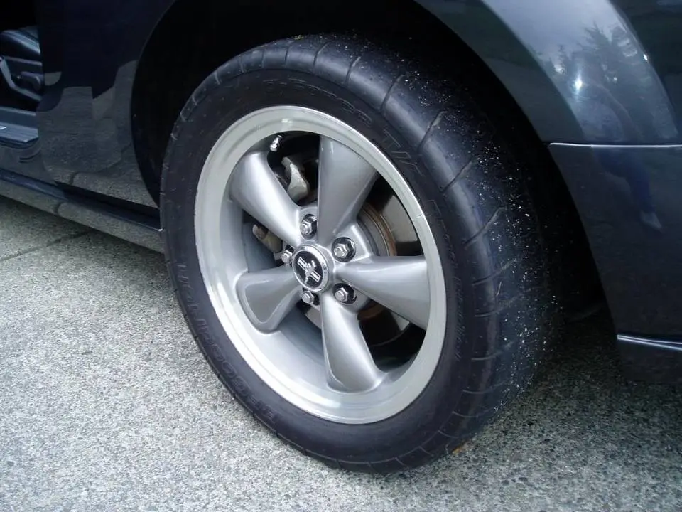

As others have said, 17x9 would be ideal, but 17x8 works just fine (at least for straight line work - wouldn't push the corners too hard that way).
I run 275/40/17 BFG drag radials on 17x8 charcoal Bullitts for drag days and it works just fine....
