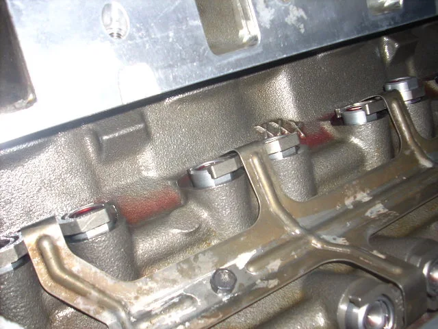

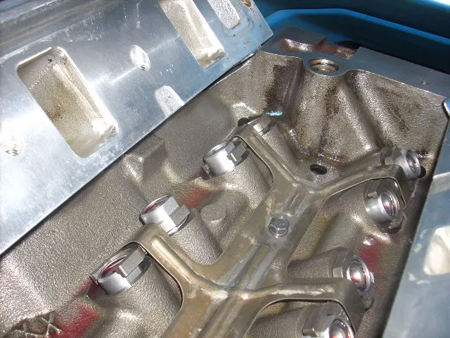

After I bolted the spider holder, I notice a few of the dog bones are not completely flat on the lifter bore. Some of the dog bones are pretty high and I'm afraid the lifter might walk out its bore. Here are some pics, what do you guys think? Do I need a new dog bone spider holder?
Please make sure that the dimples are facing up away from the block on the dog bones and then install the spider over top of the dog bones.
