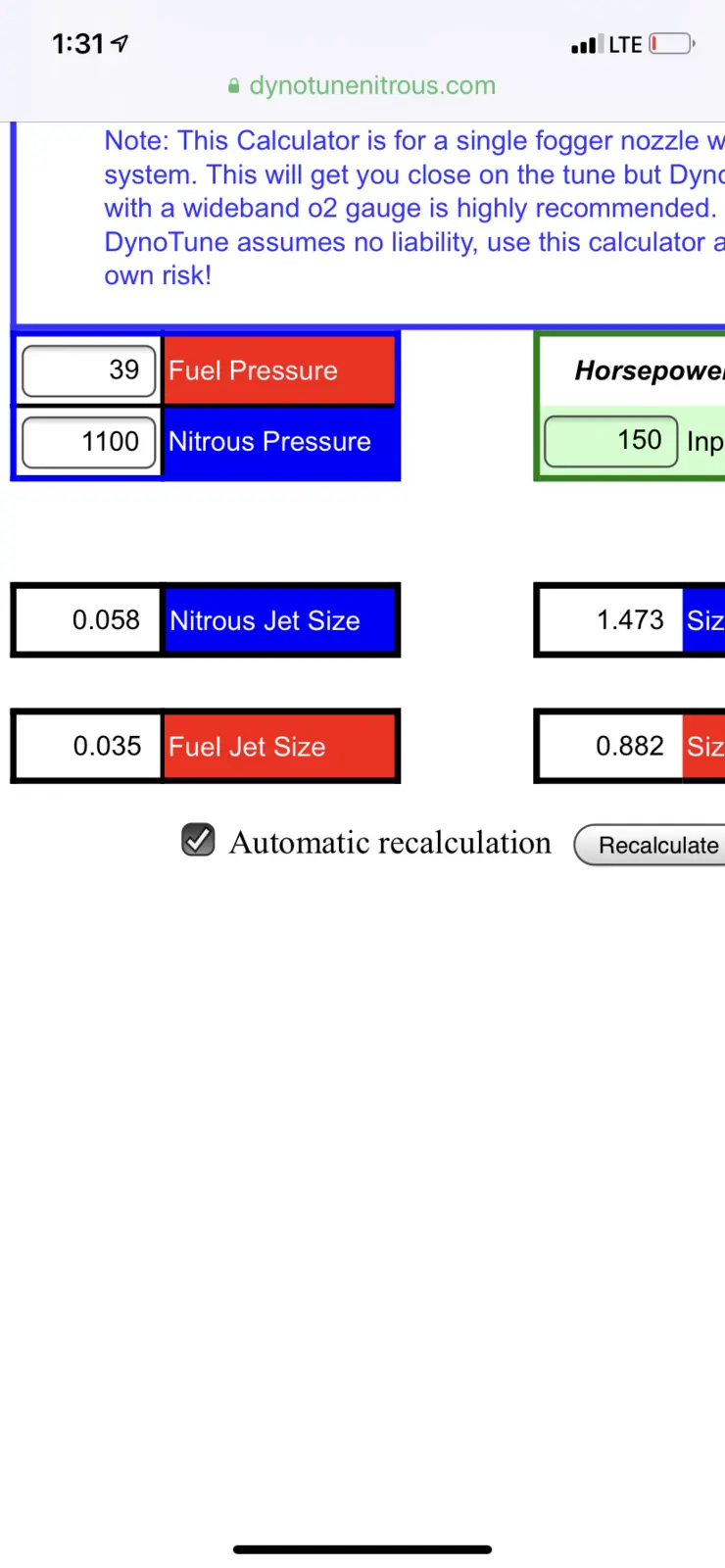

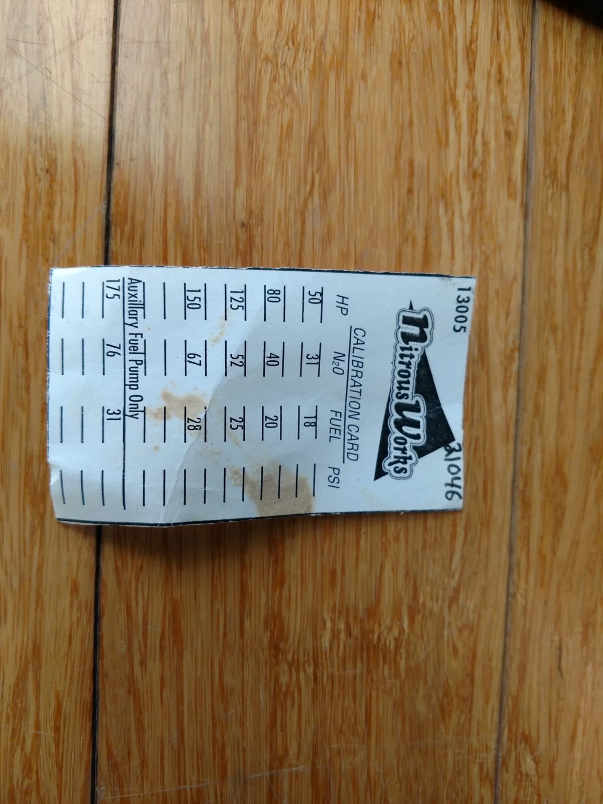

I hsve a used nitrous works (no model number anywhere?) throttle body plate and have only found one “jet chart” that says use a larger N2 and also smaller fuel jets than the online calculator for a single fogger nozzle suggests and I wonder if anyone else has this plate and/or have an educated opinion on whether I should trust this chart... thank you guys!
