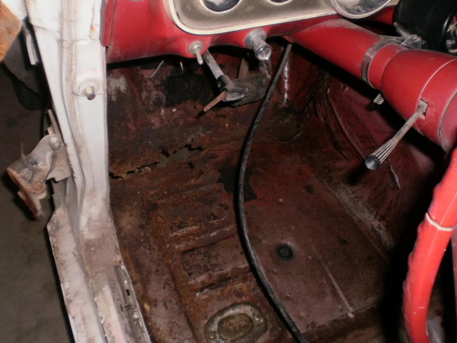

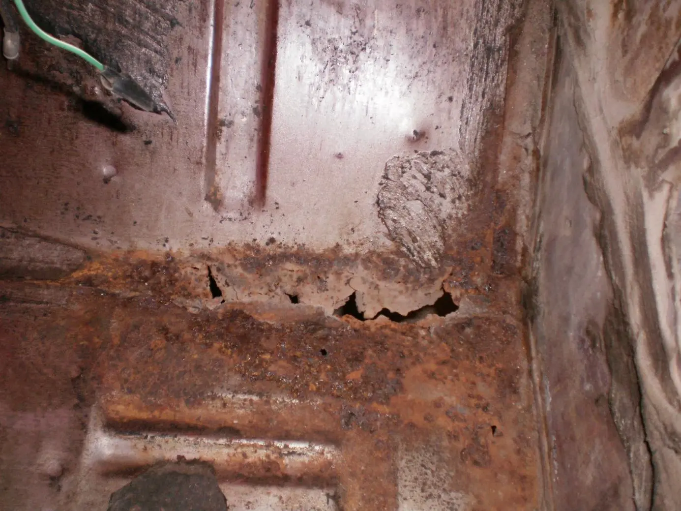

I have cancer on the bottom of the toe boards on my 65 fastback. I was wondering, judging by these pictures if i can get away with replacing just the toe board or will i need the floor section as well.
consult the pics and let me know
thanks

You can probably get by with patching the toe, but, as others have said, the floor pans look questionable. A set of pans is under $100 and not difficult if you own a MIG or know anyone that does. Add another $75 if you can't salvage the seat bases. You may be able to rivet patches on the toe but pans and seat bases must be welded.
