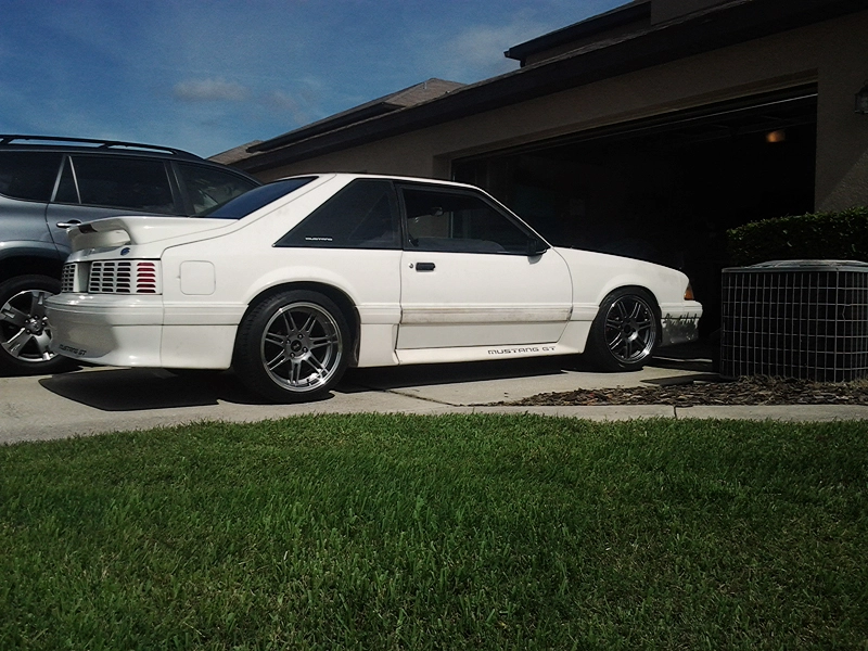

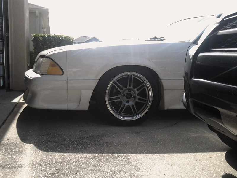

Someone on corral said MM recommends if you have at least 6 threads showing you are good. Here's some pics of the car on the ground just for giggles. Again really disappointed with the rear UPR Coilovers, wish they would have made the sleeve longer.
