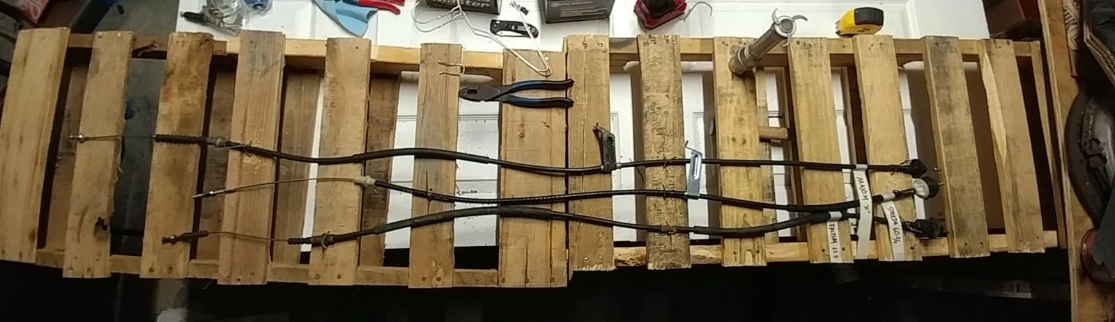

Whats the difference between those two cables?
Zero Smoke, I described this all to AM and LMR and they both believe that the Multitude of Mistakes that I made may have saved the Clutch itself. Only the replacement cable and Quad will tell.
the Wrong cable is too long and will not adjust at both ends. The replacement cable is the correct length and will adjust at both ends. The Quadrant for both cables needs to be a double fork so that the slack will be taken up. Actual numbers, I do not know yet. Once I have this one out. I will measure all 3. Stock, Wrong Cable and New Cable.
The one that I purchased first is only for the 5.0 and wont work for the 3.8

OK. Now we are getting somewhere. Proof that
1. I can sometimes be a moron and purchase the wrong item
2. There was no way possible that I was able to adjust this cable correctly.
I have them labeled and stretched out for all to see.
* The Maxim Cable is 71 inches long - Maximum Motorsports High Performance Clutch Cable (82-95 5.0L; 96-04 All)
------------------------------------------------------------ Ford Performance Firewall Cable Adjuster (79-04 All)
------------------------------------------------------------ Steeda Clutch Quadrant (Single Claw)
* The Factory Cable is 65 1/2 inches long
* The Steeda Cable is 60 3/4 inches long. - 1982-2004 Mustang Steeda Adjustable Clutch Cable Kit 5.0L/3.8L - by Steeda
As you can see the Steeda cable is the only one that will be able to be adjusted at both ends. Inside the Trans with all thread and a jam nut and at the firewall with the adjuster.
I will remove the single claw clutch quadrant along with the firewall adjuster to go with the Maxim Motorsports cable. If anyone wants to take these off my hands for a less than I purchased price. PM for the details. Once they are off I will post something in the for sale section.

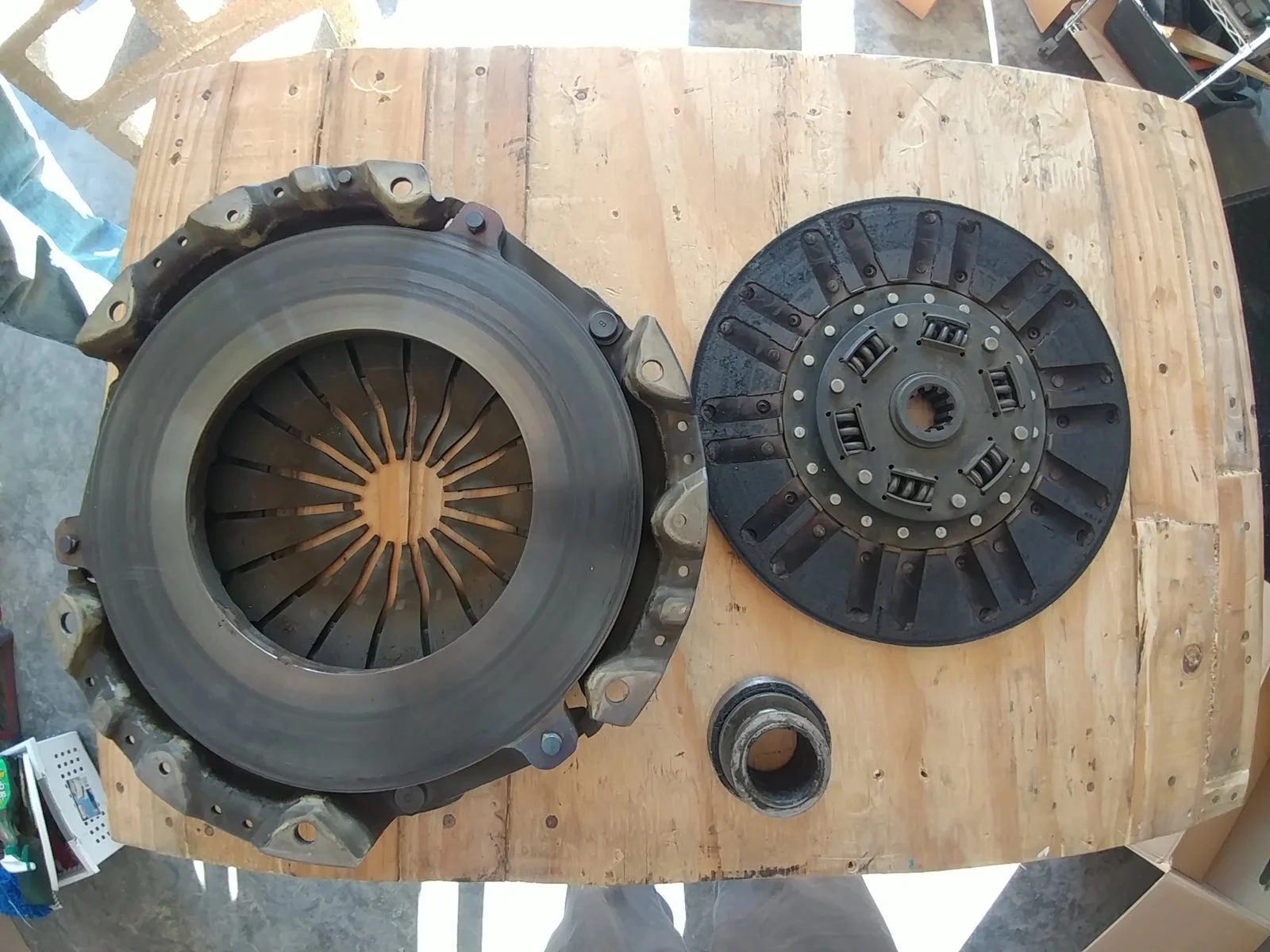

Swapped the Clutch out last night. This is what the $400. Clutch looked like when we pulled it.
Now, I have a Duralast clutch kit in it and it runs very well indeed. (Swapped everything except the pilot bearing to the Duralast Parts)
