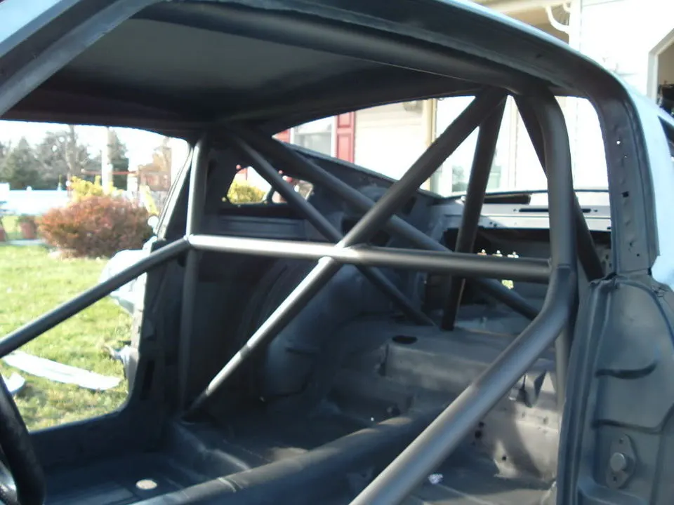

mustangman70 said:
I cant see it beemuch of a problem with just an 8 point bar, if it was a full cage yah, but i think i can get around the one bar.
Left the headliner and braces out to save weight and then just simply used "spatter" paint.
Turned out nice.

mustangman70 said:
Really? Any pics of how that turned out? and im guessing you didnt re use your dome light huh? lol
I will try to get a photograph up and you are correct on the dome light.

68FBJJZ109 said:
I have wondered how hard it would be to put a headliner in my car, I guess will see.
Nice cage!
