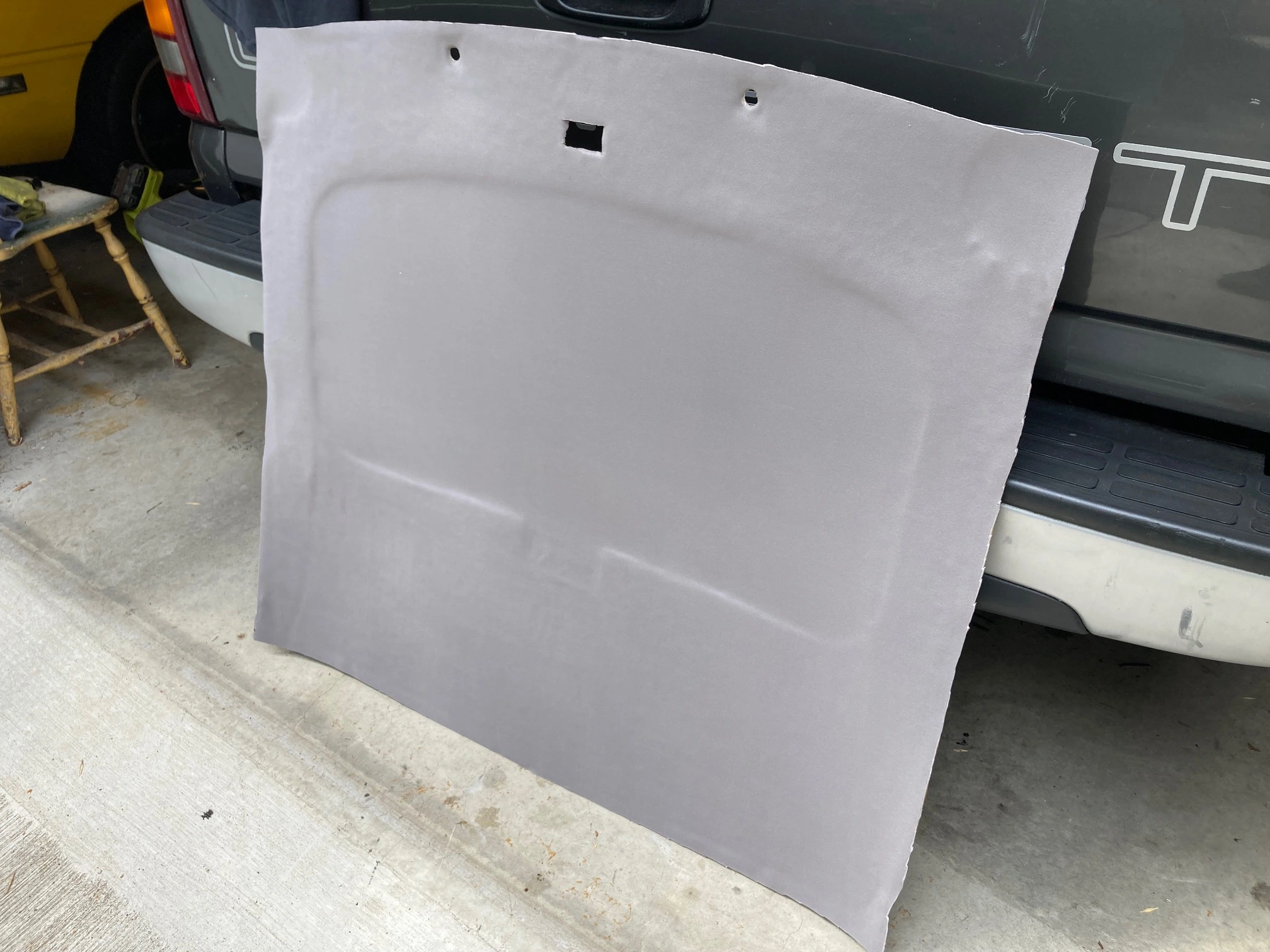

Before I spend bigger money on a new shell and all that, I want to try put new fabric on my existing shell. Any tips on the process are appreciated if you have the time to respond or share other relevant threads.
My first question is;
Is one 18oz can of 3m headliner adhesive enough to do the job?
Thanks John
Thanks John
Yes. And it needs to be [dry] before you apply the material. Purchase a foam roller (even a paint roller would do) and smooth it out slowly until you're happy with it.
It's [not] like applying a phone shield, where you try to chase the bubbles out with one shot.
If the adhesive is wet when you apply the material, it will soak/show through.
Another trick that I have seen and not tried:
When the adhesive is dry to the touch, mist distilled water over the contact side of the material before you lay it down. You will see the droplets come through the material but it's water so, it dries without a stain and is supposed to help with adhesion.

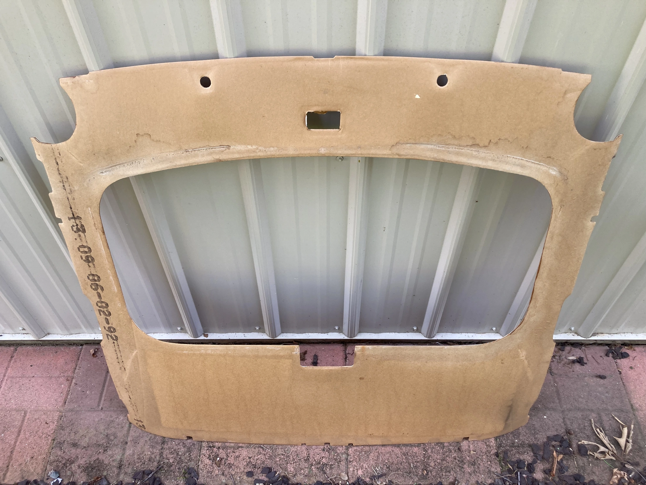

I think I’ll remove my headliner before I order anything. That way I can check the condition of the shell after stripping the vinyl. Mine is a sunroof car.

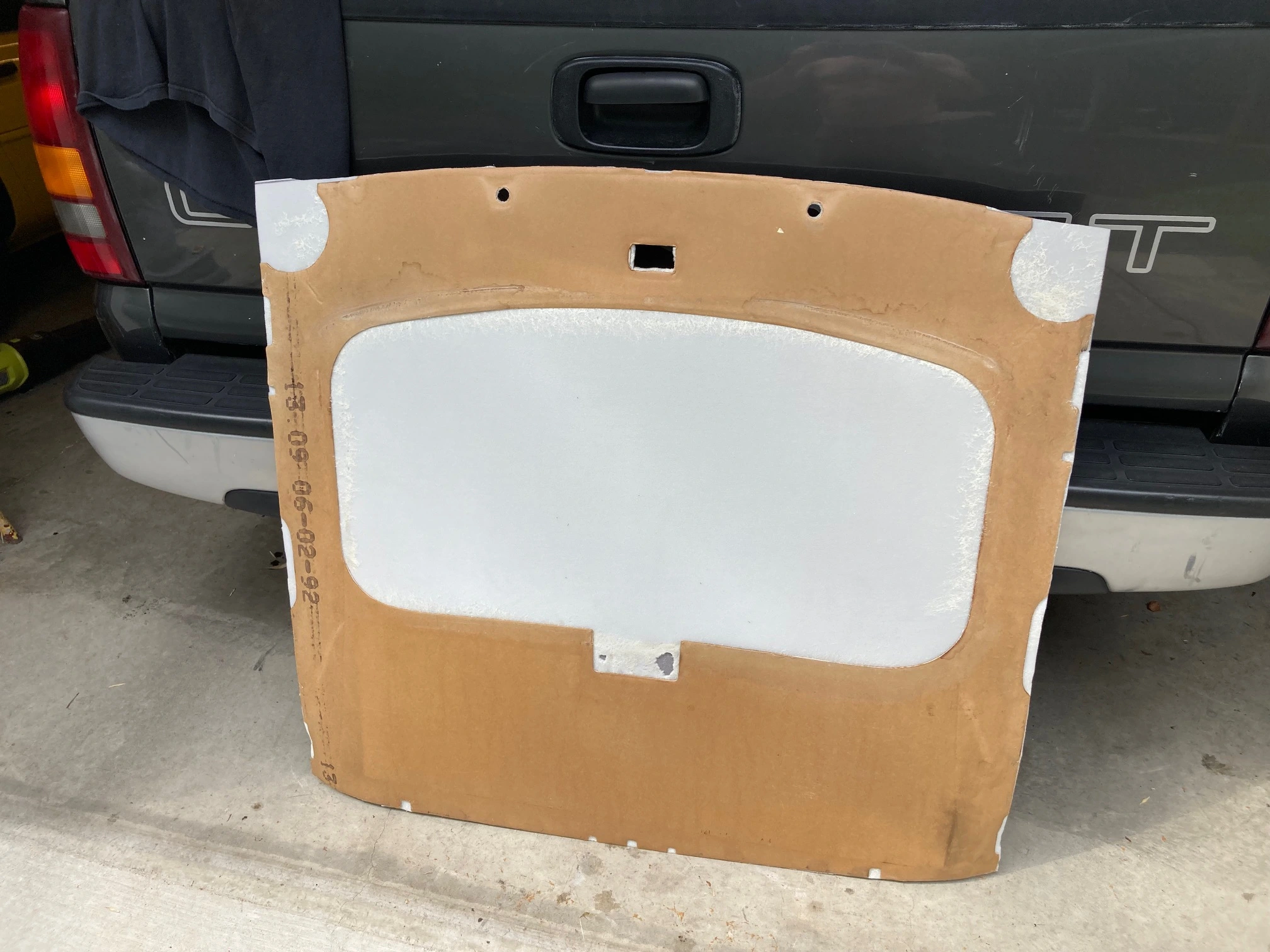

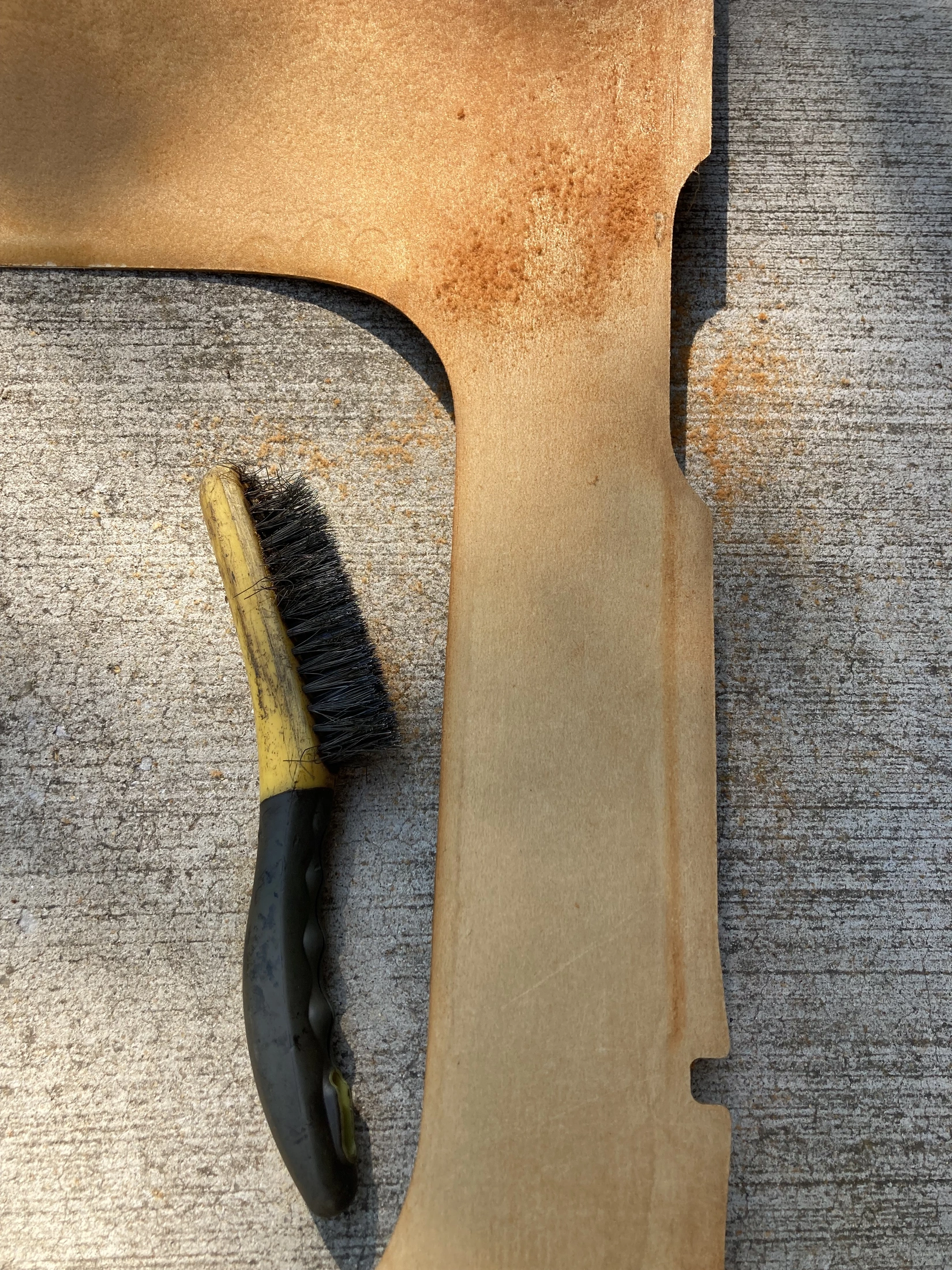

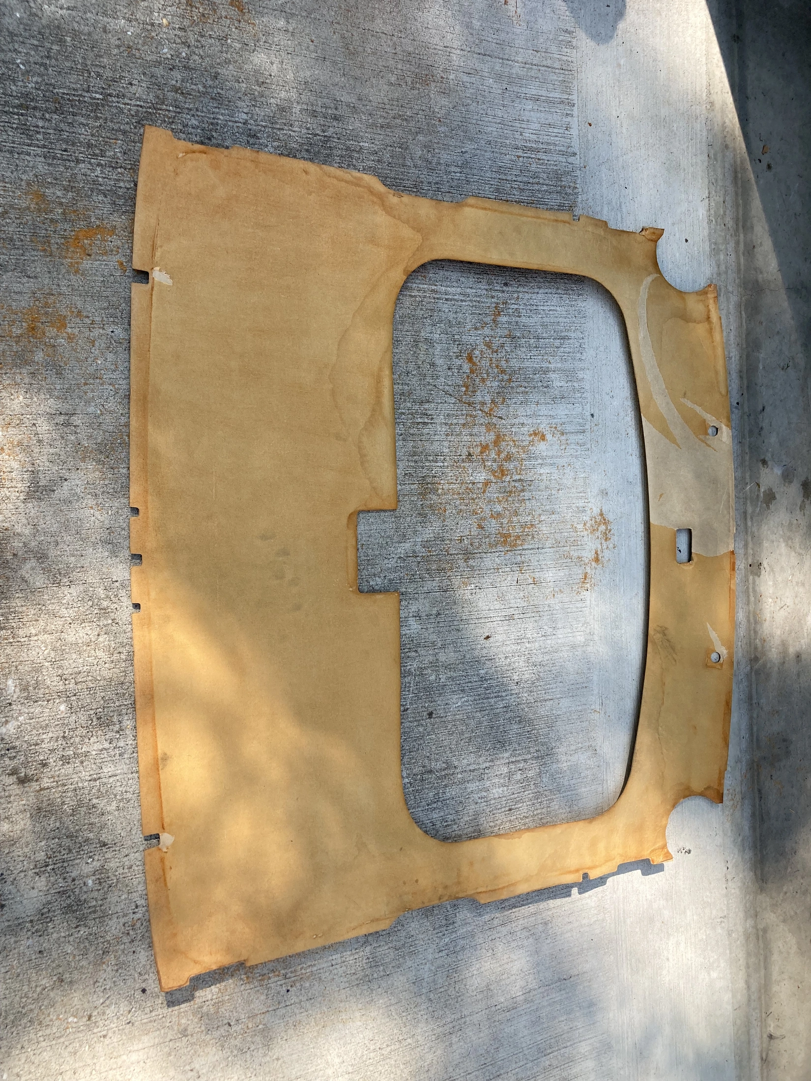

The headliner board came out fairly easy and it’s in good shape. Surely I can reuse it. I cleaned the crusty foam off with a manual wire brush. I’ve got the new material and adhesive on order.

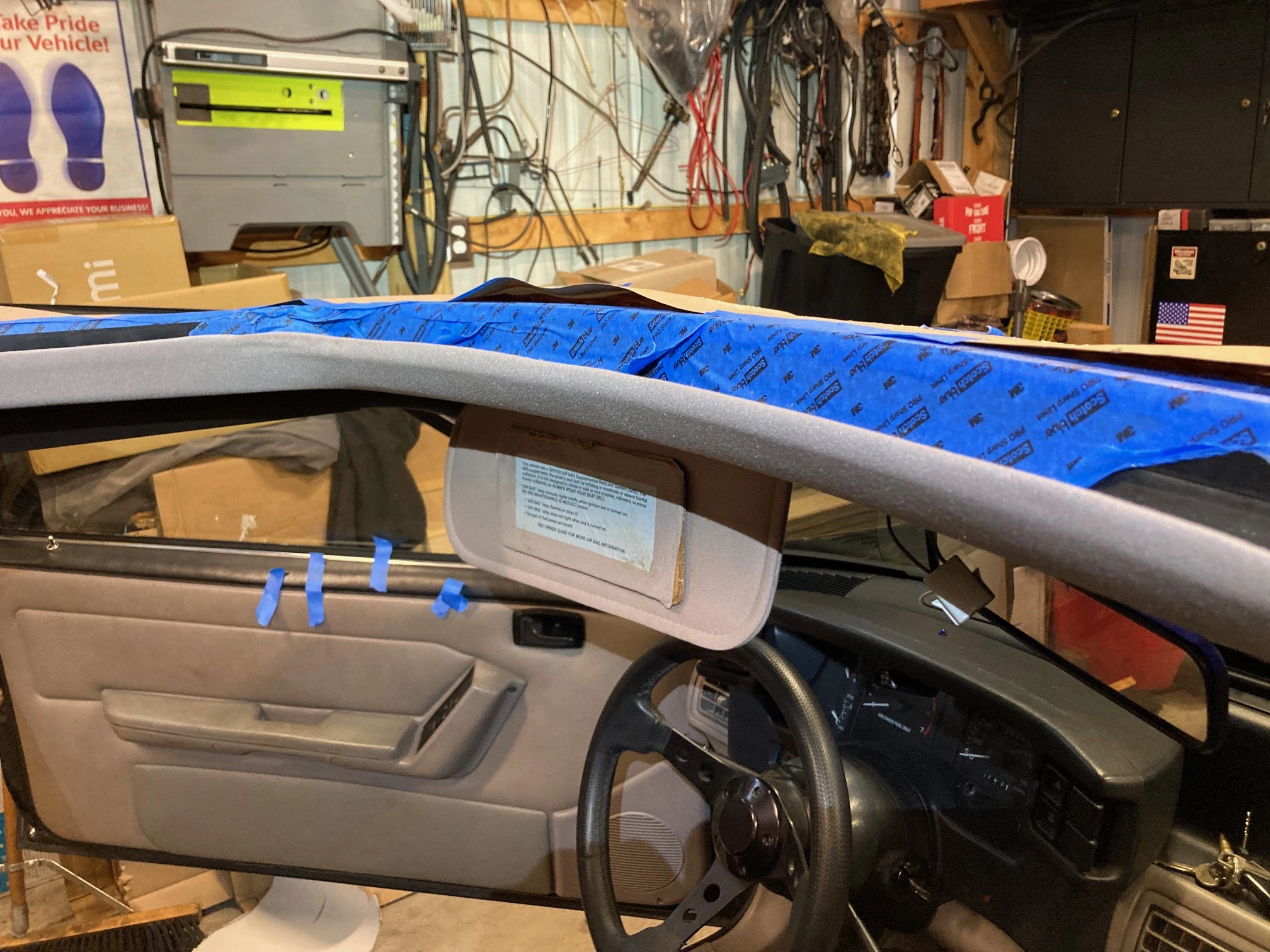

Painters tape or box tape. There will be some squirrelly end or corner that won't know how to behave. You will just want it to 'shut up and be still' until it sets for a minute or so. The tape helps and is easily removed. :D

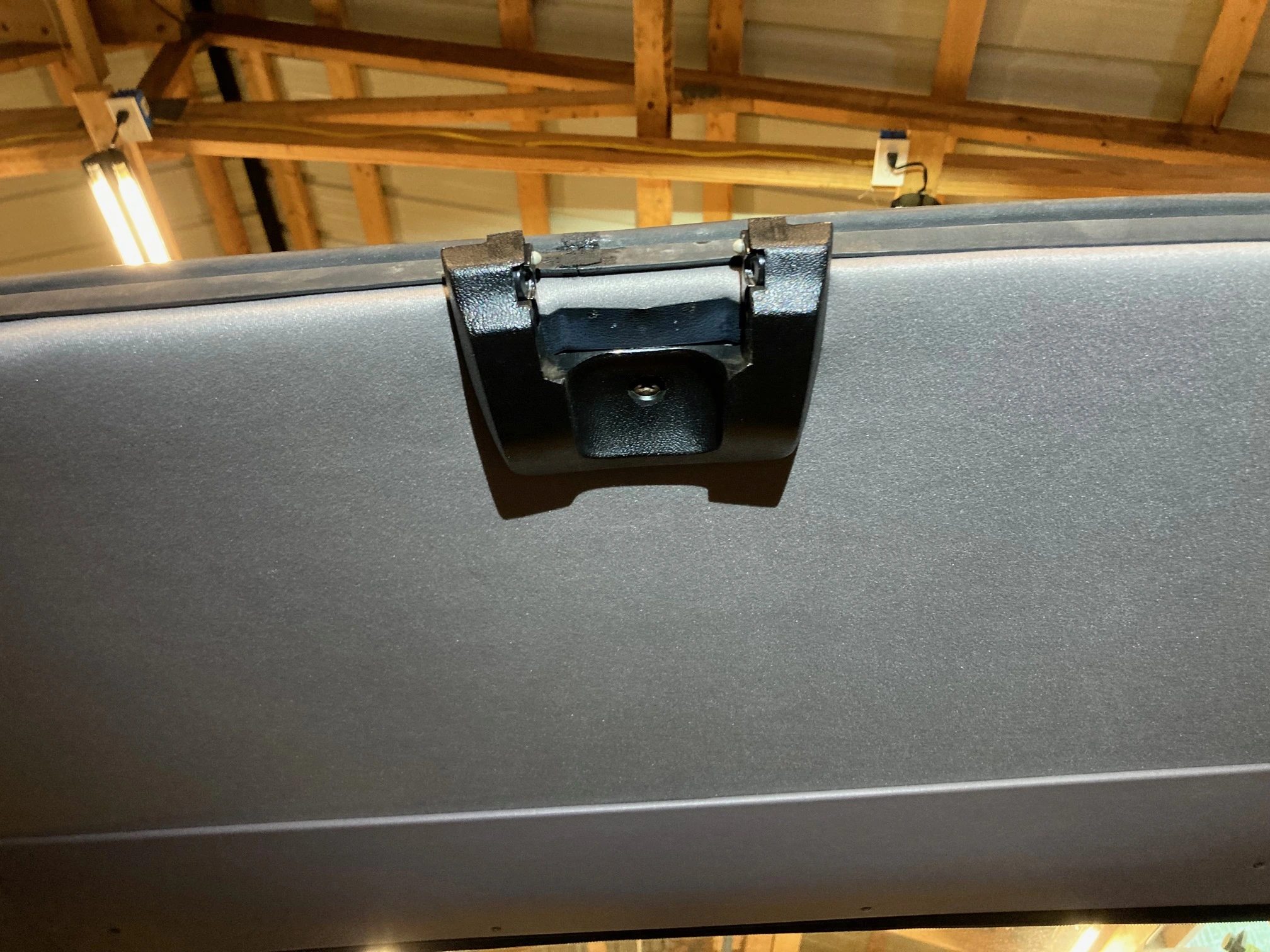

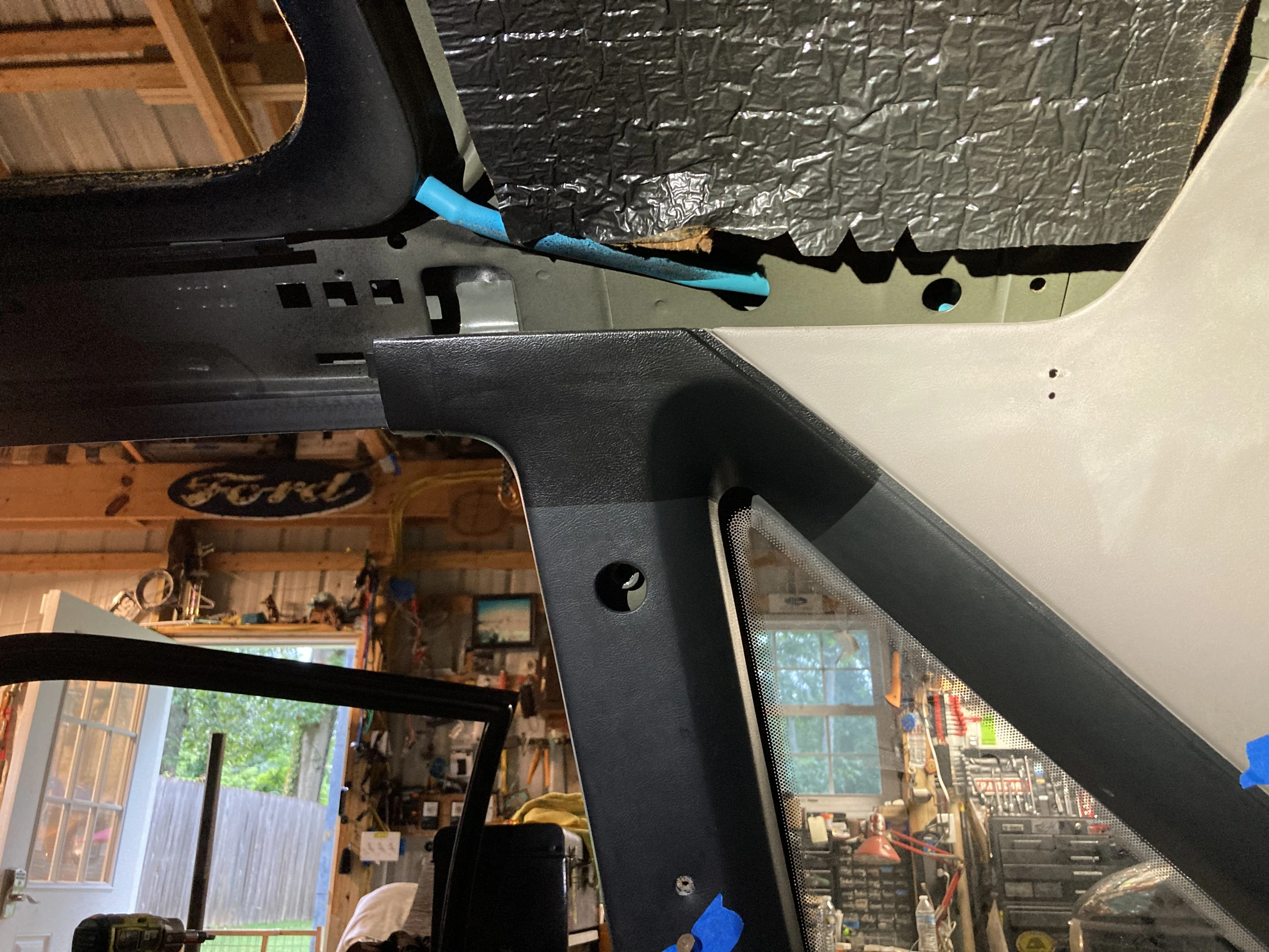

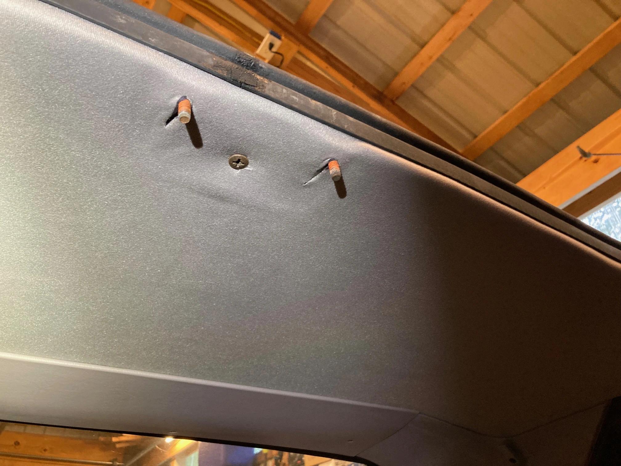

Little story about when the factory headliner failed. It was in the middle of a road trip to Ford Nationals in Carlisle PA. It well completely in the back and was blocking my rear view and flapping all in the wind with windows down. I taped it back up around the rear edges with gorilla tape. Yeah, I’m sorry I did that.
The tape held years until I just now pulled it. I had to spend time getting the tape goo off of the trim and mineral spirits on a microfiber rate worked great on every piece except the dark area of the upper rear quarter trim panel. The mineral spirits took off some paint in this area.
I thought it was black so I masked and painted with VHT satin black interior paint. Well, it ain’t black. It’s some shade of super dark grey. I can only find Titanium grey online for my 92. That’s correct for the lighter areas.
So what is the correct color name for this area on a 92 LX hatch with Titanium grey interior? Closest thing I see that might be the same is listed for 90-92 Bronco. Here it is
Bronco Dark Chacoal

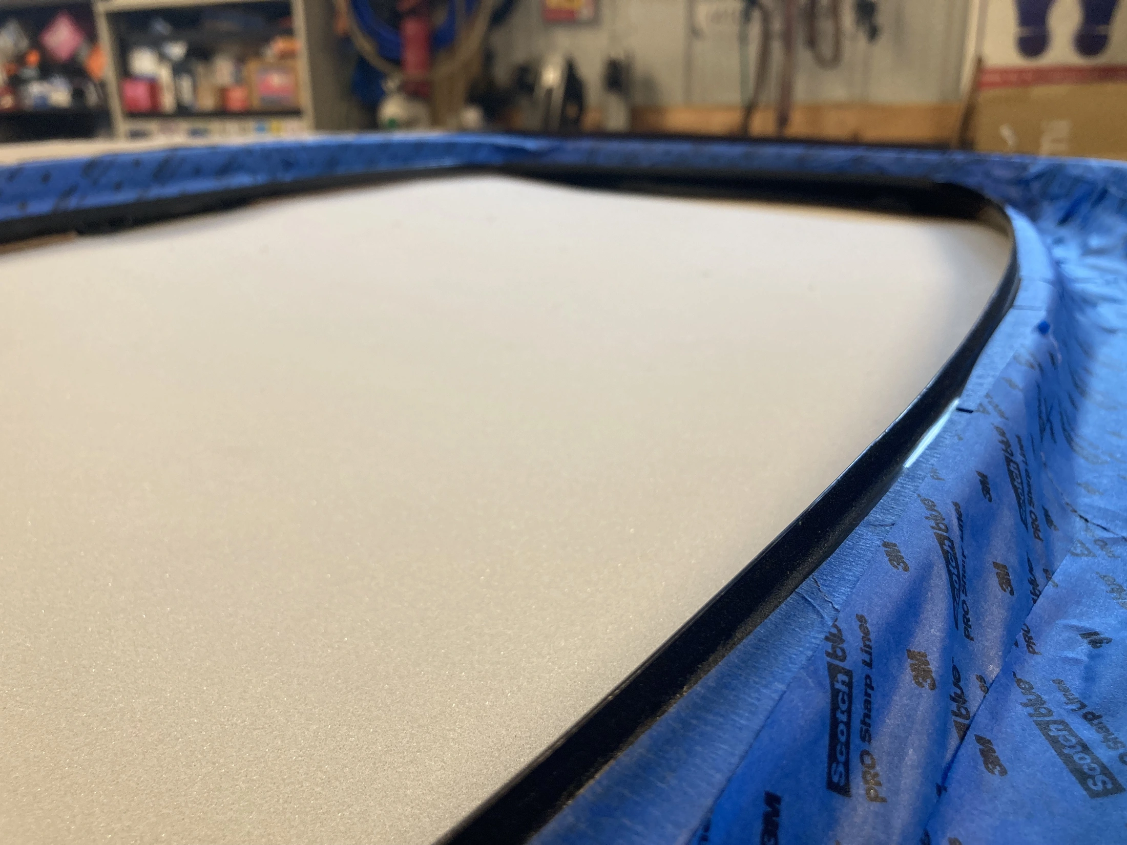

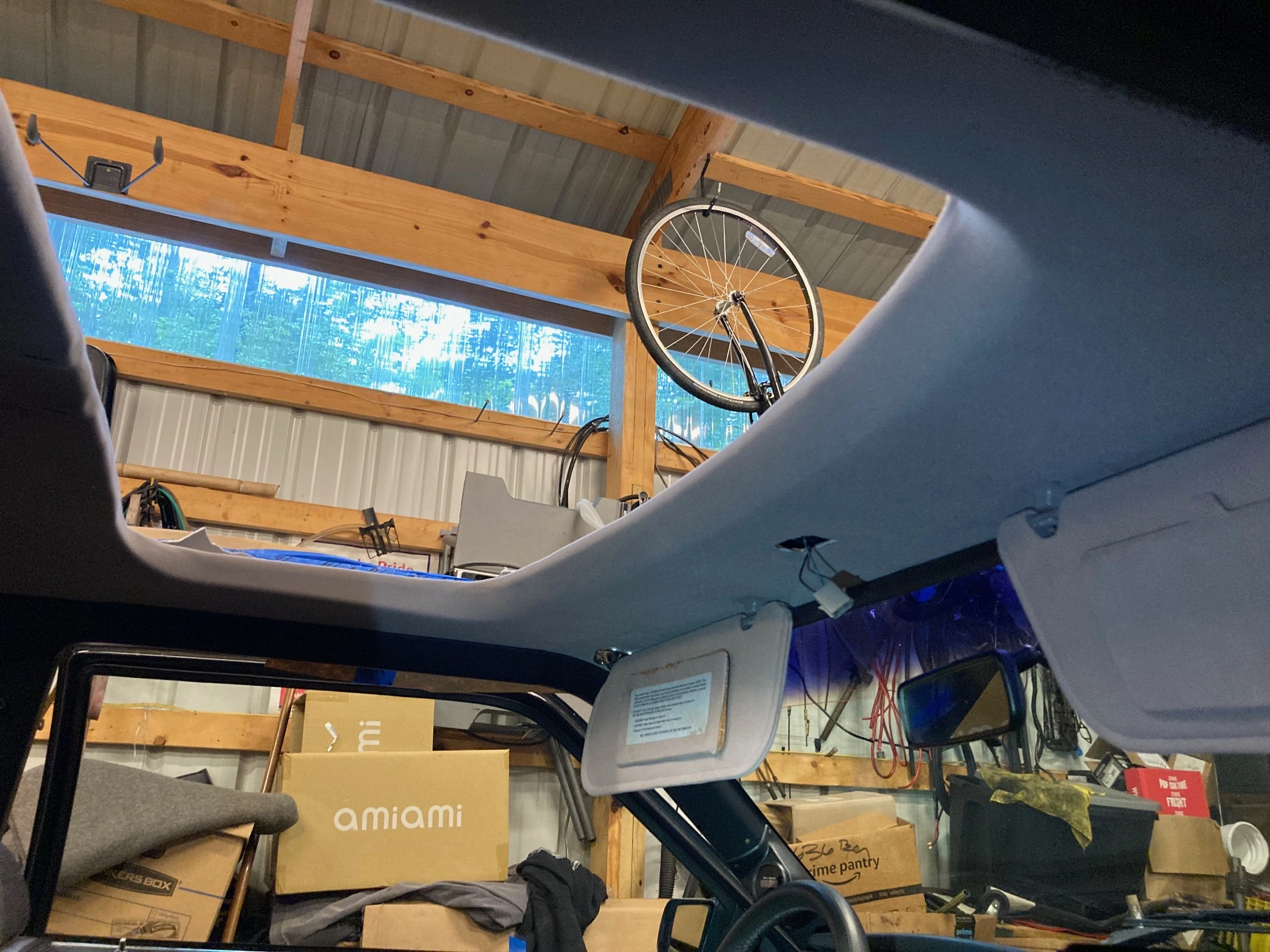

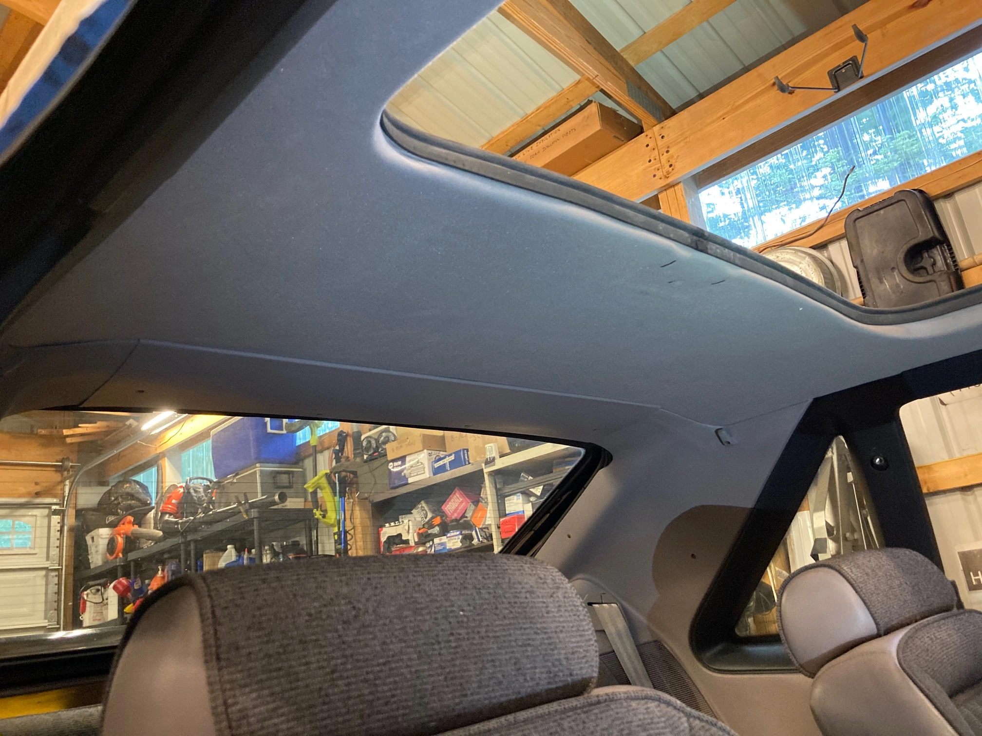

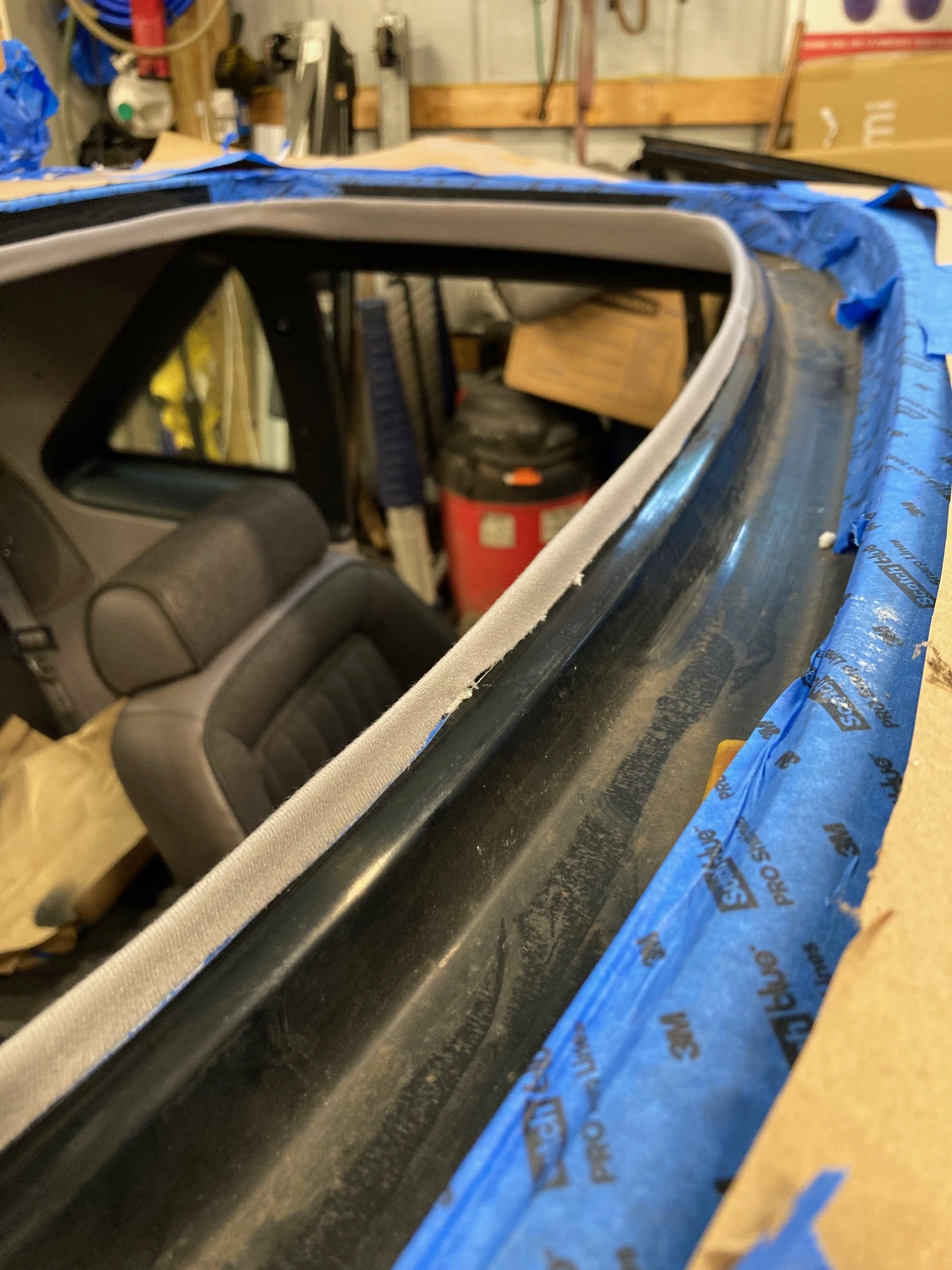

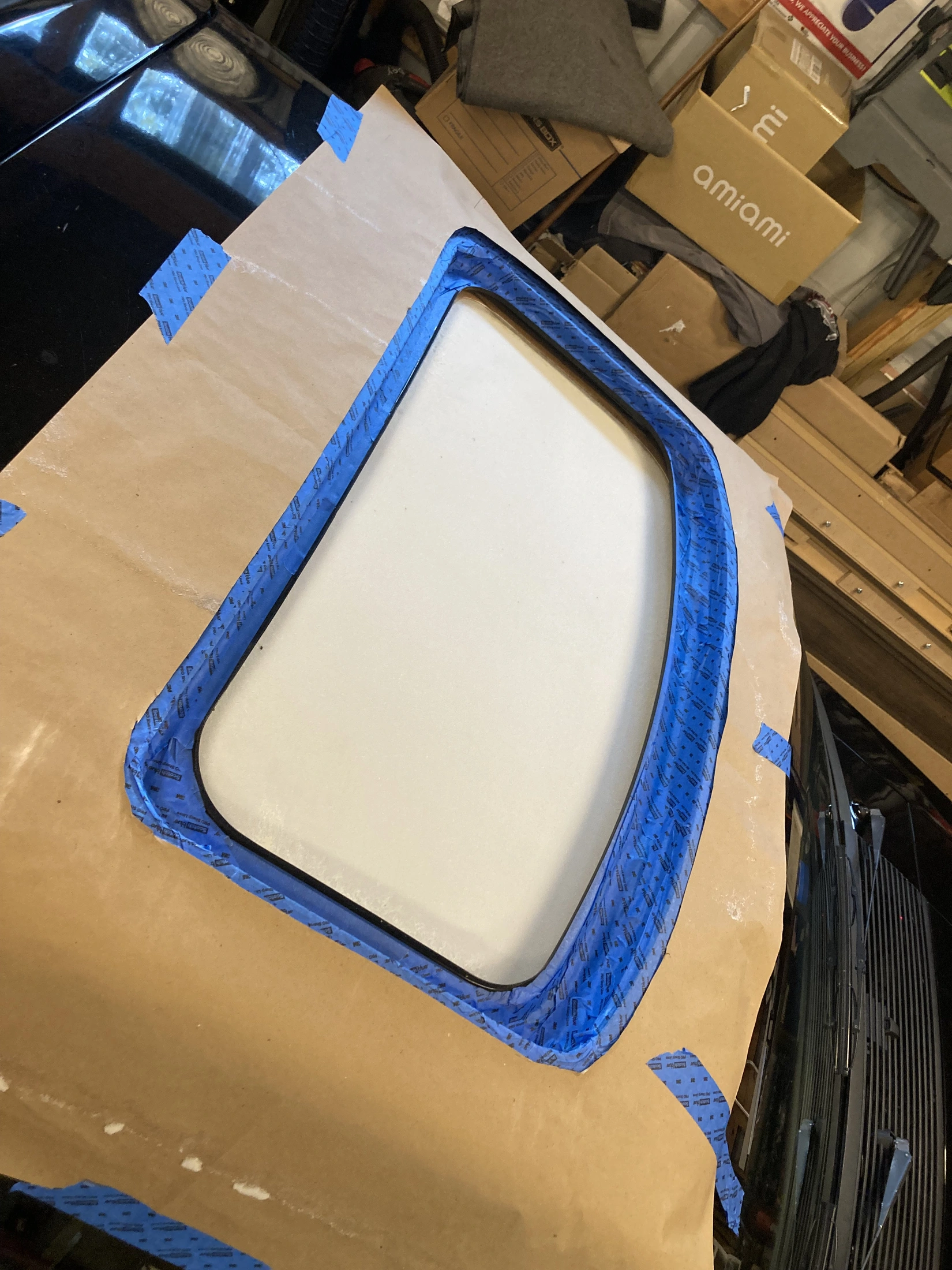

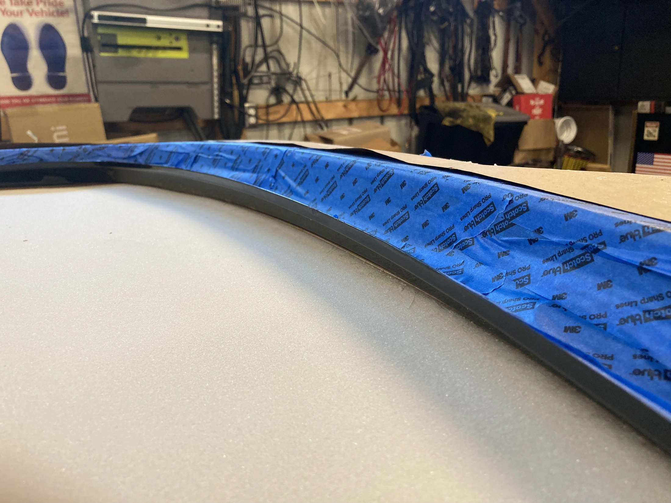

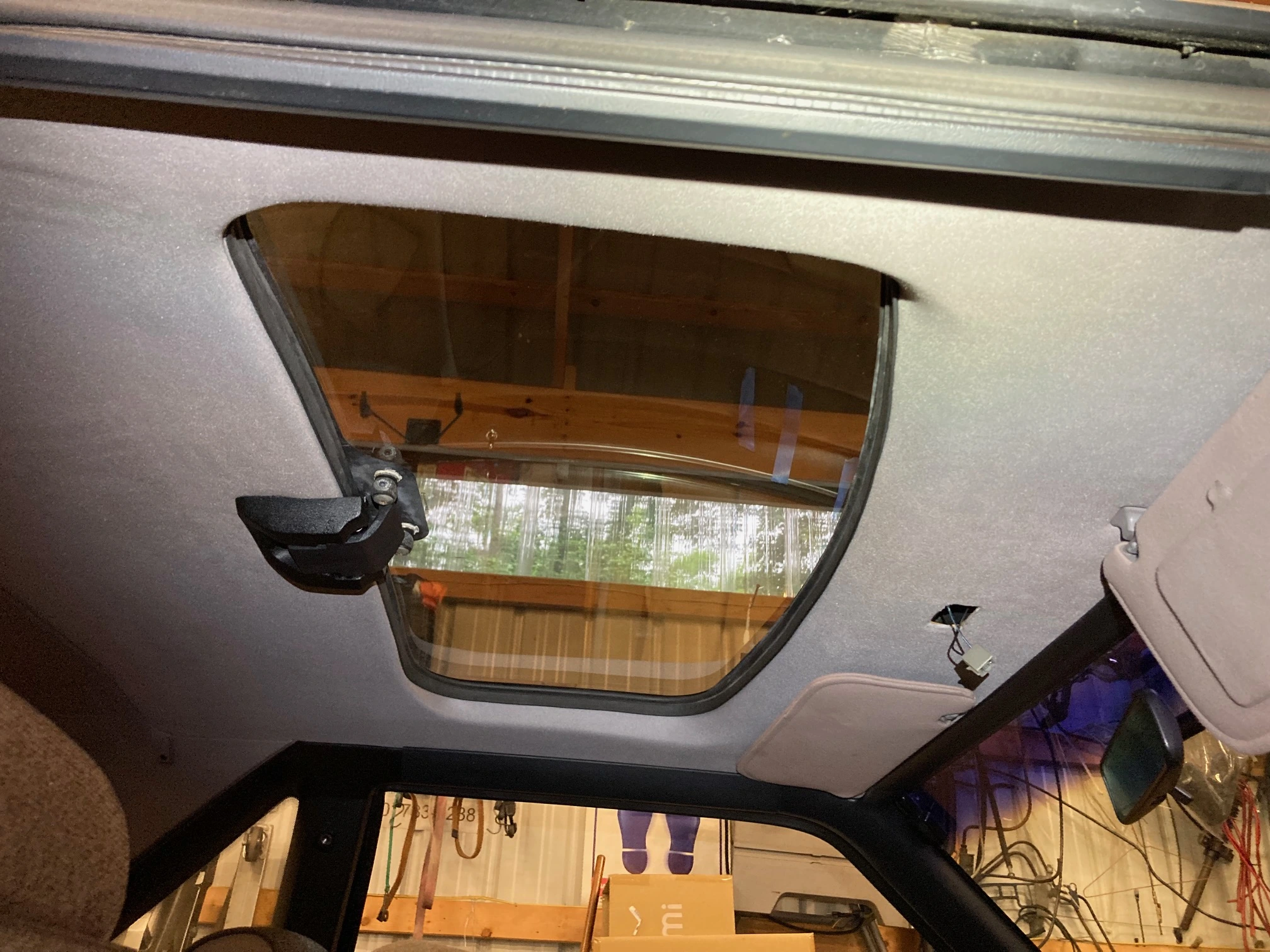

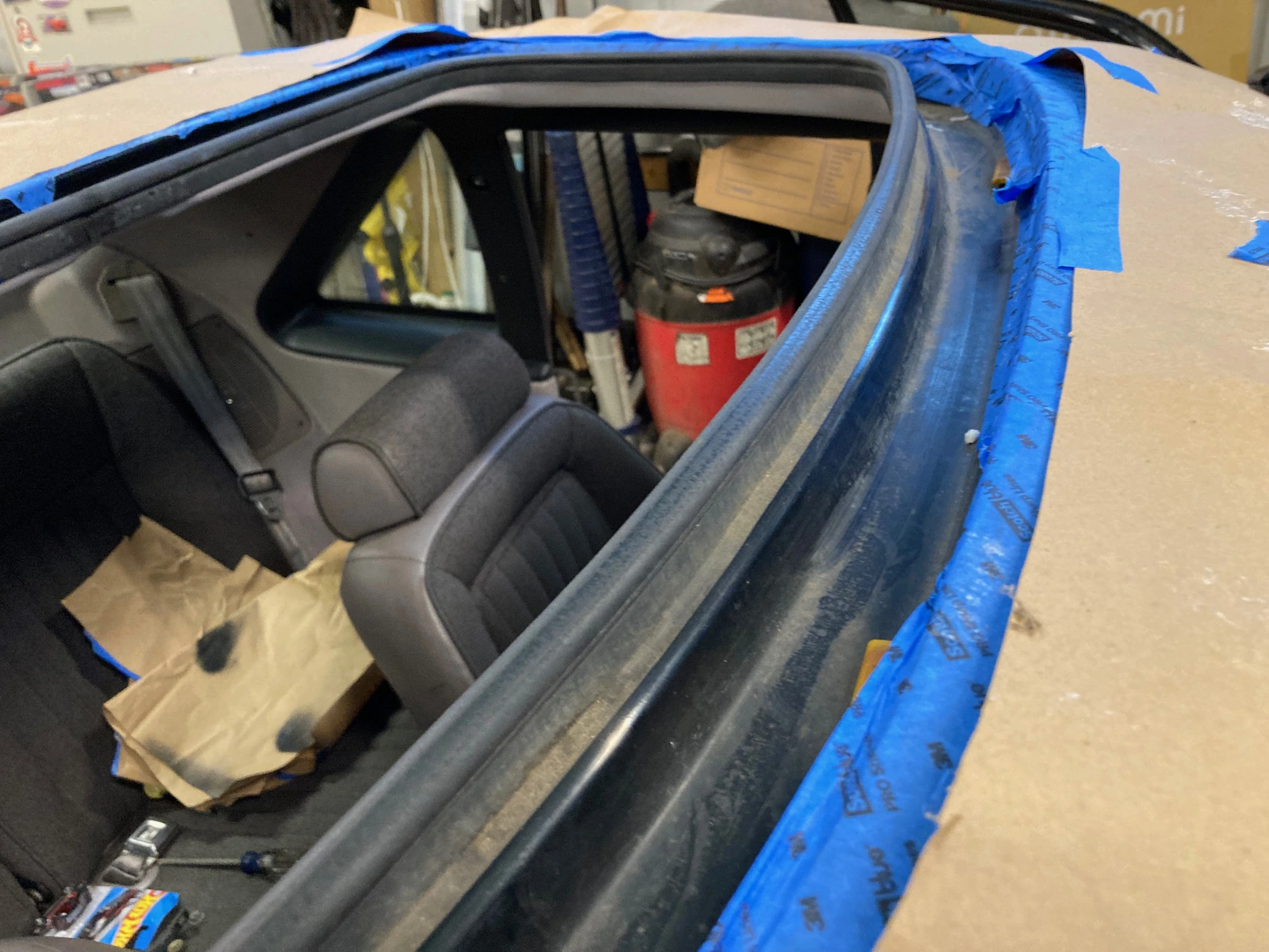

I have no idea why I didn't do this fix sooner. It turned out great! It wasn't even that hard to do provided you exercise a bit of care. To finish off I applied the adhesive to both sides of the lip and the headliner foam, made the cutout leaving about 4" extra around all sides, snipped a little slack for the corners, pulled the material up and wrapped around the lip and pressed it down, trimmed the excess with a razor, peeled all the masking off and snapped the weather strip seal back on. Without rambling further, I'll let pictures do some talking.
