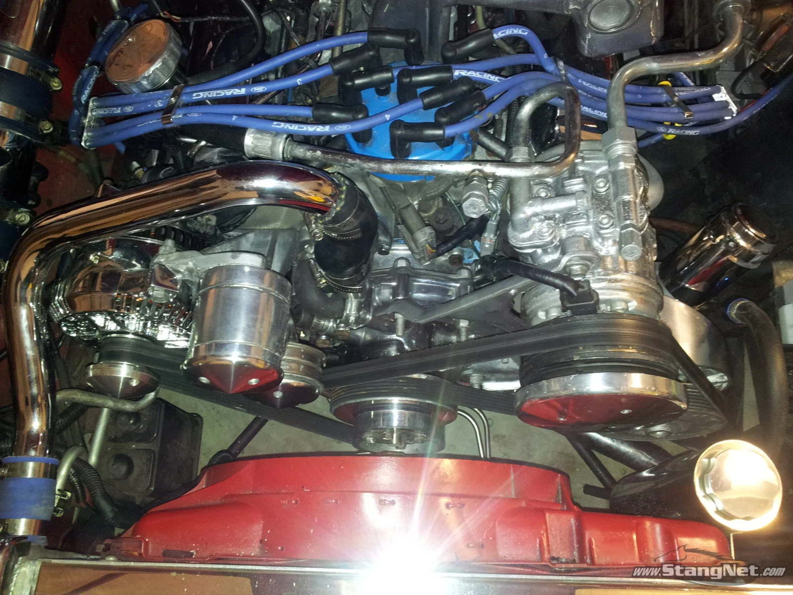

Very bad pic but you can see how I have min on the driver side of the radiator next to the taurus fan
