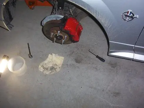

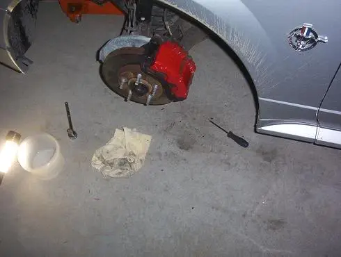

I used brushed on duplicolor for mine on the mach, and I used spray for the ones on the GT i used to have. Never removed the caliper for either one, just masked everything off and did it in the garage so no wind to blow overspray around.

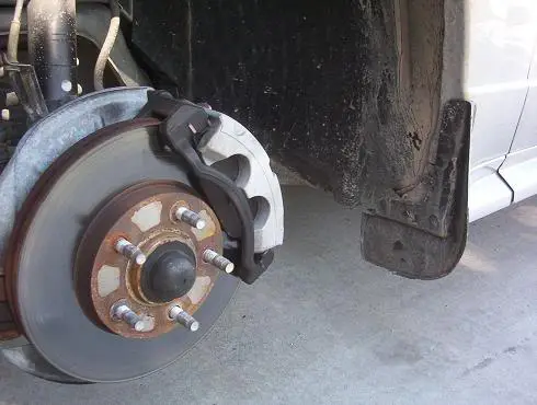

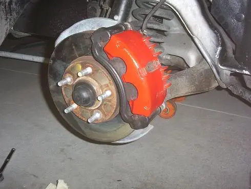

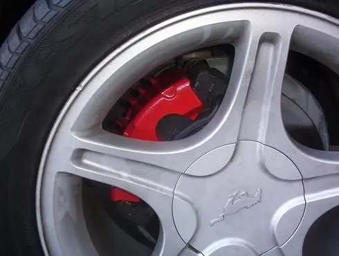

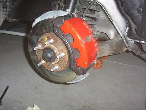

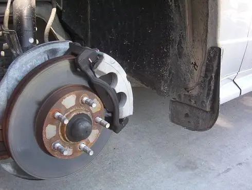

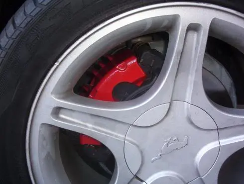

You do not need to take the calipers off.
The Dupli-Color kit is definetly the way to go... no overspray.. VERY easy to do... and you do NOT need to cover the entire caliper in paint just the visible parts so taking it off really isnt required it just makes it easier...

As long as you have no problem masking everything off, it should be fine. Even take plastic bags and cover the disc, etc.
I'd take sheets of plastic (cut garbage bags will work) and cover 1/2 the hood/the entire fender.
Then use a coat hanger and bend it up to hang the caliper, tape off the inside (where the piston/pads go) and the brake line, then have at.
If it is brush on, then make sure you clean it up very well.
