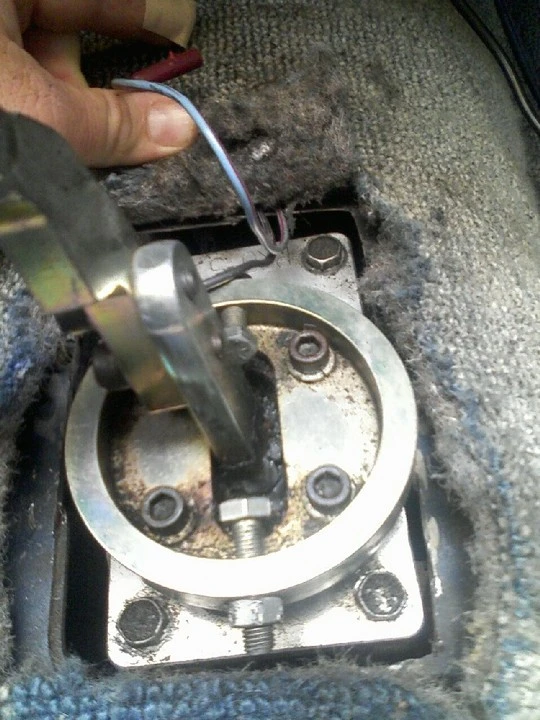

I was talking with someone who said he unbolted the circular gold part from the rest of the t5, bolted the pro 5.0 shifter base to the trans, then lifted the trans up, bolted it down, THEN bolted the circular part of the pro 5.0 down. In this manner he was able to avoid cutting the tunnel.
in my case, I have a beat up x T code coupe...so I don't mind taking a cutoff wheel to my body :)
I think I have a C-code (2bbl 289). :scratch: Mines a little beat up as well. Been in the family since 69 and driven often (close to 250K miles). It was my daily driver for 5 years to and from college. So, I'm not too worried about a little trimming around the shifter hole.
Thanks for the tip.
Here a quick shot. She's a 30 footer....LOL.
All of my mods so far had been bolt on restmod stuff, except for the T5. It really hurt me to hack on my baby for the sake of overdrive, but all in all, it was well worth it. I had to remove about an inch of the shifter opening, on the front.
You can get away without cutting the floor by installing the shifter before you install the transmission. The only thing that sucks about doing it this way is you wont be able to remove the shifter for any reason unless you remove the transmission. I chose to cut the floor in mine because I like to change the fluid and fill it through the shifter hole.
