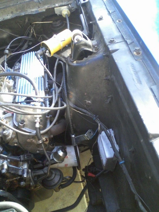

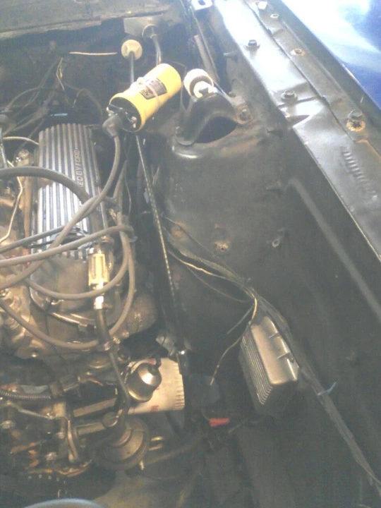

DO NOT use his suggested cable. He uses a fox length adj cable, which is too short to clear headers..it cannot be routed properly. I found through research and trial, that the 96-04 adjustable cable is a perfect bolt on fit with his quadrant and clears all the header tubes up top by a mile. He is aware of this, and I put it on his forums...see a picture below of the cable installed on my 66.

I have to fix the hosting on my pictures, or I'd show you more...the above shot is the only one I have right now
fixed my picture hosting...
The above pic you can see the firewall adjuster and cable.

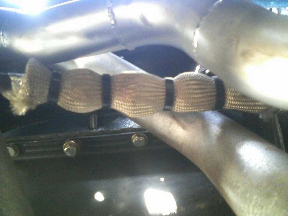

The below picture is how I had to modify the 88300 hedman headers. I had #5 tube relocated, and then used heat tape, a rubber hose, then spark plug insolater boot. It still does not tough the tubes and it's doing well. You can see the tube above that was reconstructed

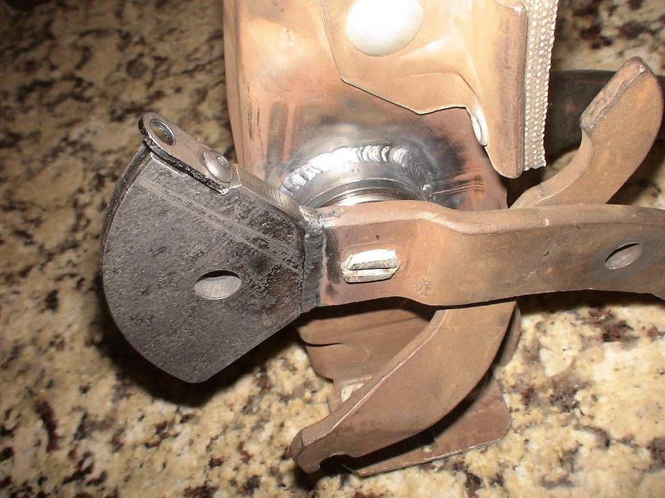

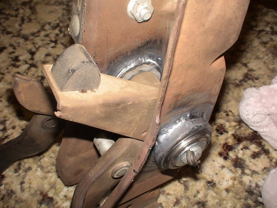

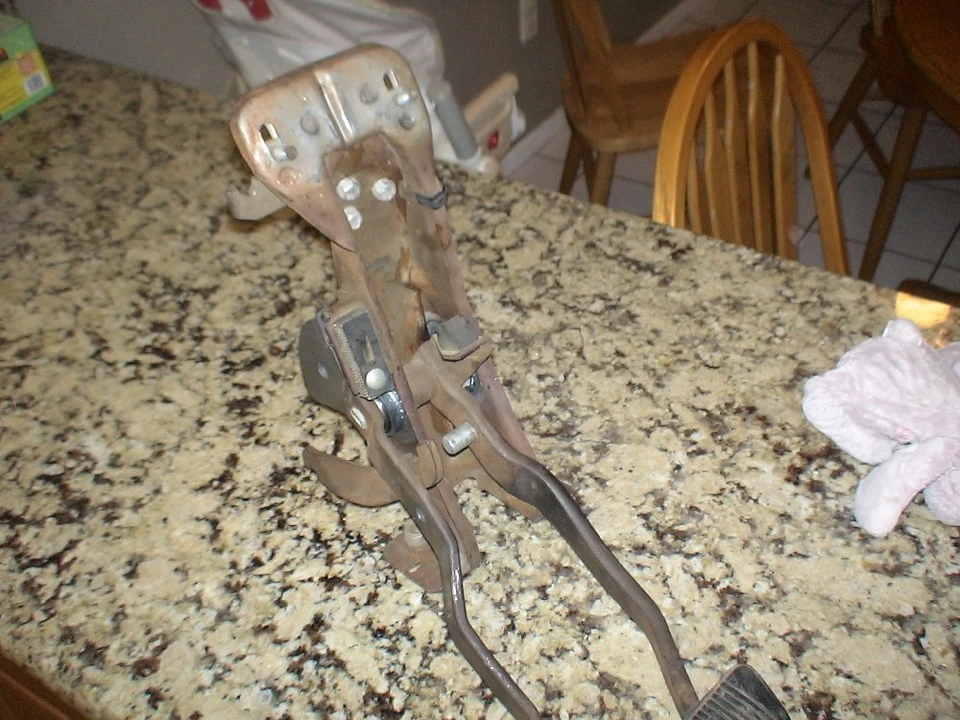

This is an original clutch pedal assembly I scored for $40!!!! it's been modified with the mustang steve quadrant and roller bearings

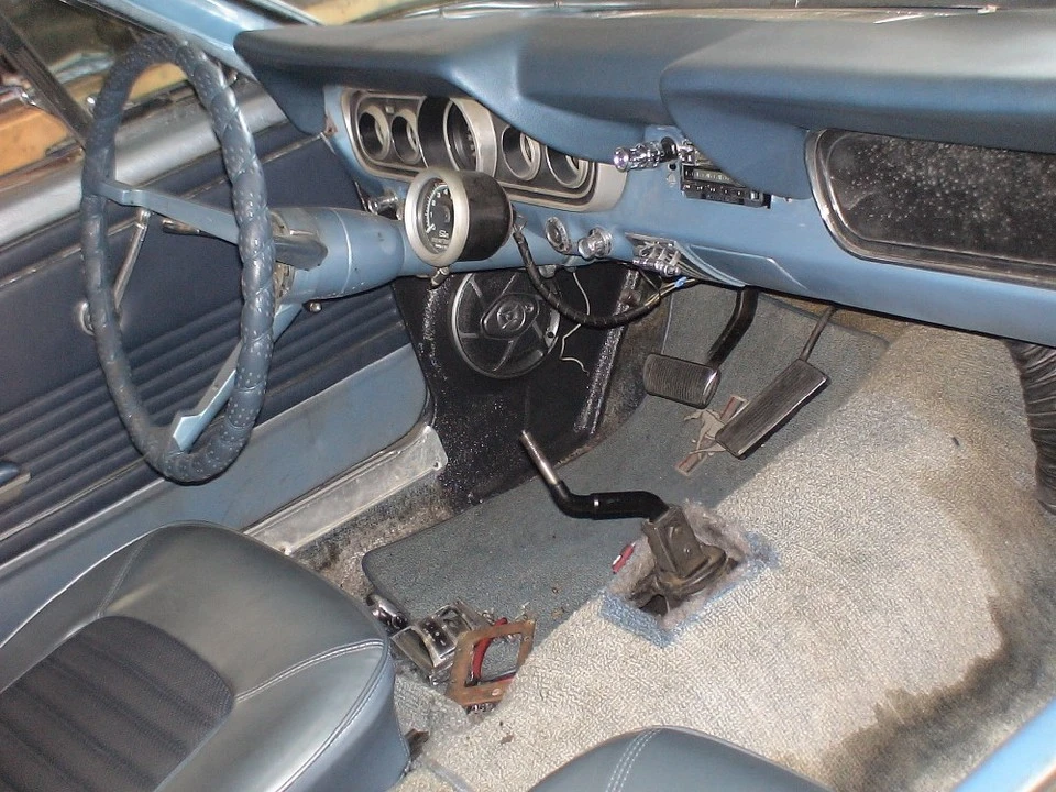

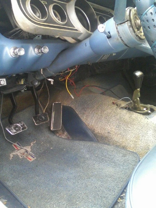

this is a picture with a crappy hurst short throw shifter. it cleared the tunnel without cutting anything

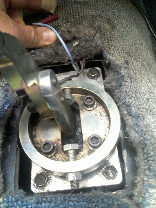

Here is how it sits now. I trimmed a tad off the right side of the tunnel, and a couple of inches out back for shifter clearance, and installed a pro 5.0 shifter. I have a perfect 6x4 hole, which I'll cover with a boot soon enough

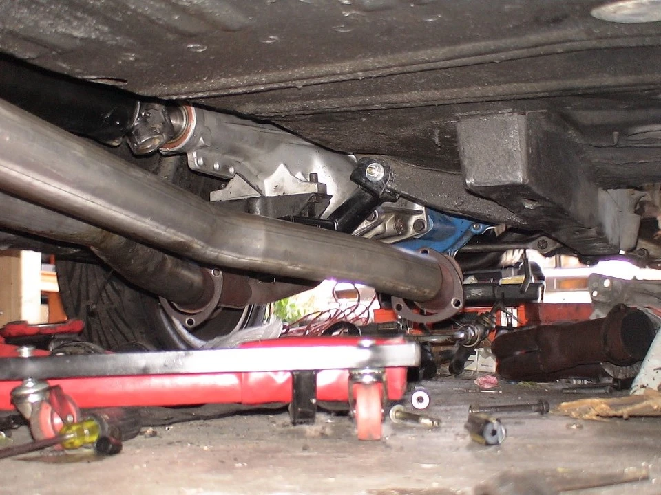

Here is an undercarriage picture with the t5, and the trans x member.
the trans x member was a ****ty fit. I had to grind the hole in the x member quite a bit..as it wouldn't align with the frame holes on the 66. Once I opened the holes up, it worked perfectly. I've heard others with the same piece I have had the same troubles. I've "HEARD" that the ron morris x member works with no problems
you can also see the driveshaft in this pic. It's the stock c4 driveshaft. I had a shop shorten it 3/4 of an inch, rebalance it, and stuff new ujoints in it, then paint it. cost me $78. I've been hearing though that you may not have to shorten your stock driveshaft. Try fitting it first.

How's the reach to the pro 5.0 shifter?
How's the cross-member in terms of driveshaft angles? Any vibrations?

but it doesn't touch, and that's with triple layer protection. the 88308's and the 88300's won't work....unless you PULL the cable away with a zip tie. This is why I had the tube rerouted. you'll destroy the tube after a short while. I had a friend with the 88300/88308's and the ron morris clutch cable kit, and his cable hit on the headers too.
the reach of the pro 5.0 shifter for me is fine. Most would find it annoying though. You do have to reach, and a longer handle would be ideal, but it's not too bad.
no vibrations at all yet. I've done about 65-70 on the freeway. We'll see when I get my 8.8 in if I can still say no vibrations
