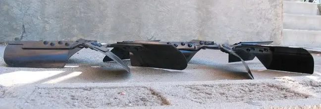

What kind of thermocouple does the setup use? If it's one of those cheap things that poke into the radiator fins, that's half the problem right there. The fan being inadequate is the other half.
On thing I found interesting is that not all stock 50blade fans are created equal, especially after 40+ years. My radiator is a three-row brass and I used the stock '68 fan with a shroud and it would borderline overheat in outside temps over about 75°. I literally found a mid-'70s five-blade Ford part that has stiffer blades with more curvature. It looks otherwise identical to the old one, but works a lot better.
