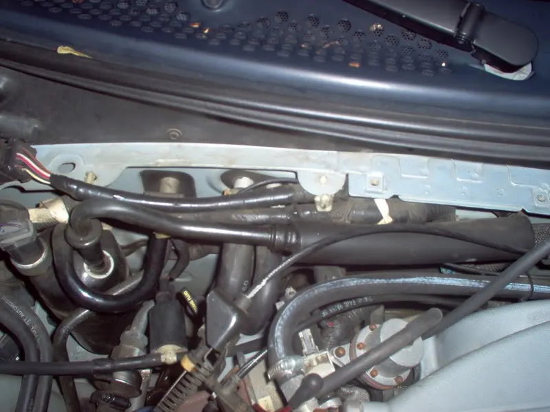

Trying to get car running TODAY, but I got impatient during teardown and did not look at wear 2 lines went . the lines are located on the elbow. a valve screws in and there are two smaller "Nipples" on it for vacuum linesand one larger one strait ou the back of it. Where do they go.
Also, is there an electric plug on the factory air silencer. I seem to have an extra plug in that area too.
I KNOW, I'm an idiot, i just got excited with the new parts

Hang on "Miller'.....I am transferring the pics as we speak...have to go thru photobucket....

Perfect, so where does the bigger hose go?
Hate to have you do more, but do you know by chance what you have the four lines hooked up to that are underneath the intake.
1.Vaccum tree 2.PVC on lower intake 3.FPregulator 4.blocked
that is how mine is hooked up right now.
I just want to make sure that i don't do something stupid to f-up my idle.

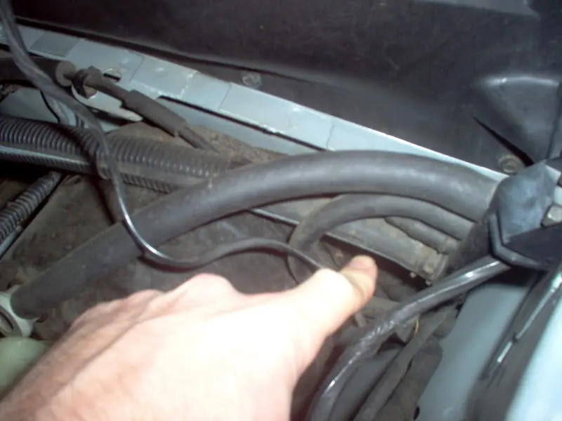

I remember the big line goes into a 'T"...I snapped it off and had to replace it......give me a few minutes and I'll go take a few more pics of where they go.....there is a couple of fittings under that intake......I had to buy a fitting adaptor from Napa......if I remember...lol......anything else you need a pic of..?

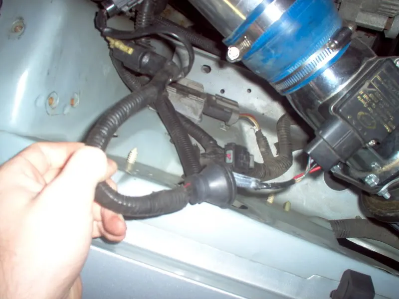

off the top of my head there is only one more thing that i can think of.
on the same wiring "loom" as the alternator cable. there is a plug that i am geussing goes somewhere, but i am yet to find out where. It should be close to where the cable connects to the fuse box, i think it may be to the washer fluid. It has an orange washer inside the plug.

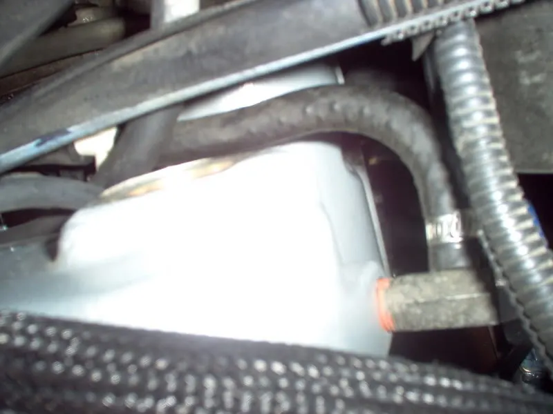

This is where the "large" line from the elbow goes.......driver side fender....mine is one continuous line

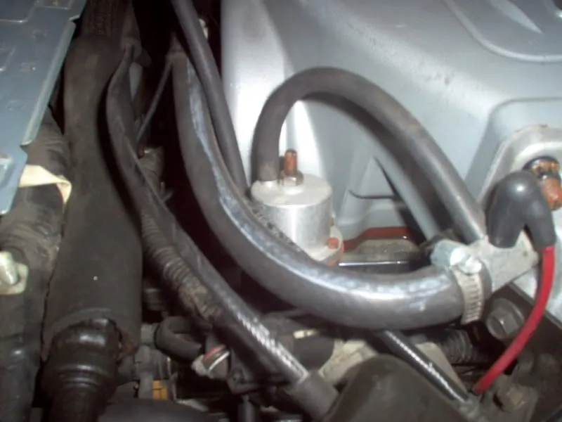

This fitting is on the driver's rear of the upper intake.....if you follow it back toward the passenger side you will see the white "T" vacuum tree.....

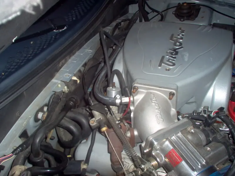

I slid the camera under the intake.....best shot I could get...

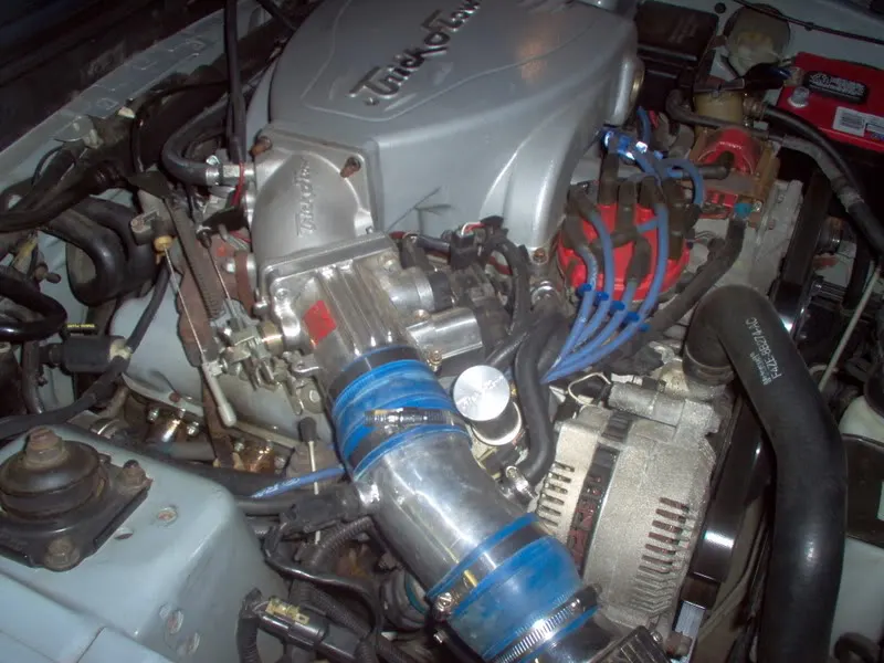

and I thought you asked about these connections...
