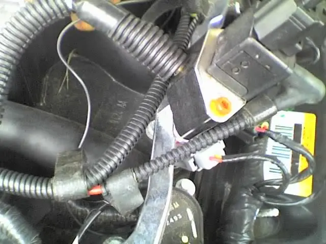

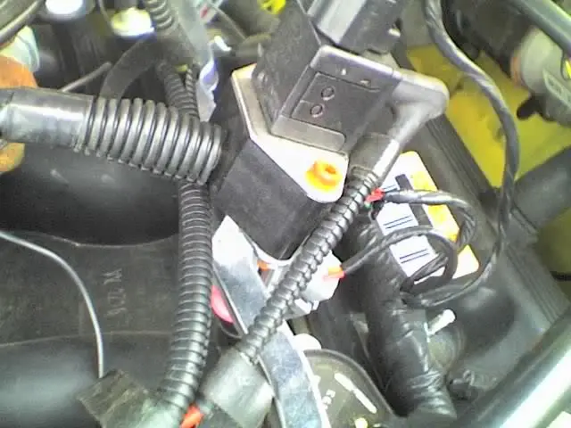

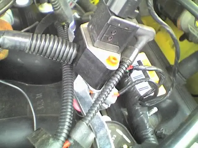

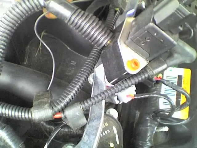

Does anyone have a picture of the NX Fuel Rail Adapter installed on an '04 GT? I'm ordering mine this week, and I'd just like to get an idea of how it works before it gets here. Also, for a 100 shot, does anyone know where and which NX jet kit I should buy? I'd like to jet the setup for 75 to start and test and then up it to 100. I bought my kit used so it's missing some parts if anyone's wondering why I'm asking these questions. Thanks!!!

I'll get you a pic when I get home later this afternoon. ;) It's a very straightforward installation.
install. takes all of 5 minutes.

OK, I have my fuel rail adapter, and haven't tried to install it yet, but I can't really tell exactly how it works from the pictures. Sorry for my ignorance, but can someone give me a step by step of how to install it? Is it plug and play or do I have to modify the fuel rail? I've never hooked up anything like this before and I usually don't mess with EFI cars so I'm kind of in the dark. Thanks.
Plug and play.
Look on the driver side fuel rail. You see the shiny silver thing with the black square on it? has a connector on the top and a line plugging in on the backside, toward drivers fender.
Unbolt it. Pull it up and out. FUEL will come out.
Slide the NX fuel rail adapter into the hole where the part you just removed was. Slide the boxy thing into the top of the NX fuel rail adapter.
Use the longer bolts supplied by NX to tighten down to the fuel rail.
*** make sure to tighten any unused opening on the NX fuel rail adapter. there should be at least 1 if not 2 cap head screws with it. *****
