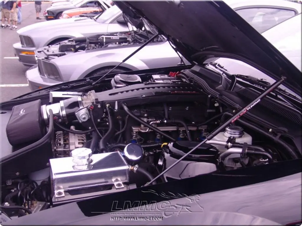

I have been running the WMS CAI since I bought the car in 2005. Started out with just CAI and a tune, in 06 installed a Saleen Series VI
upgraded the original mass tube from 80mm to the 95mm. 3.6 pulley
39 lb injectors. Dyno'd 440 to the wheels on a Mustang dyno. Never a Hiccup with the WMS. I too think it's a great looking setup especially on the end of a Saleen SC
Looks killer. I notice you have a Outerwares cover for the filter. I have a red one I put on for shows. :)
