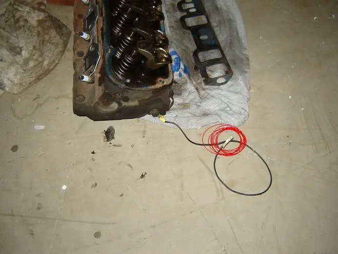

I never connected this cable, some people said it could be to some aftermarket thing. Could this be the problem? What if I connected the other negative side of the jumper cable to the engine??
i also see some smoke sometimes coming from the negative side of the jumper cable. is that bad?
