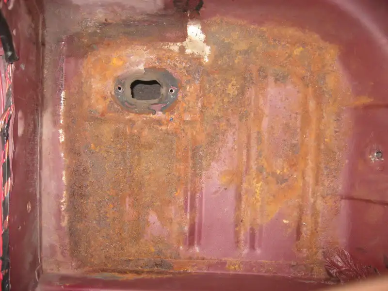

i had the same rust spot in the trunk of my '66 coupe what i did was removed the gas tank cut the rust spot away(around tank mounting area) and weld 18ga. mild steel plate in its place and mount the gas tank from the bottom
i used lincoln welder wire feed mig welding that into your regular home outlet should do the job

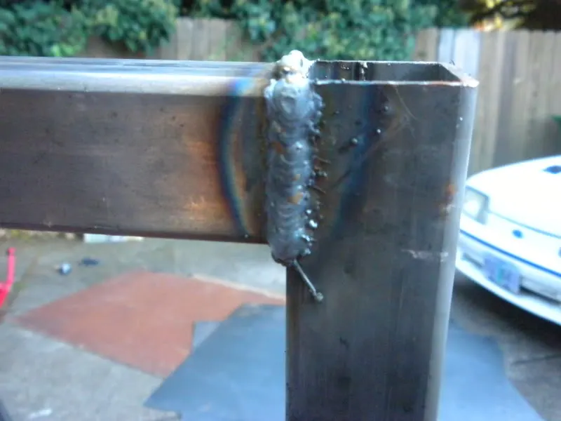

before working on your car, take on another project. I built a brew sculpture as practice. It gave me the opportunity to figure out what worked and did not work. It also gave me hours of time on the gun without making a mistake I regret.
oh, and wear your gloves. I managed to weld my wedding ring onto my finger.
The first time using the welder.
