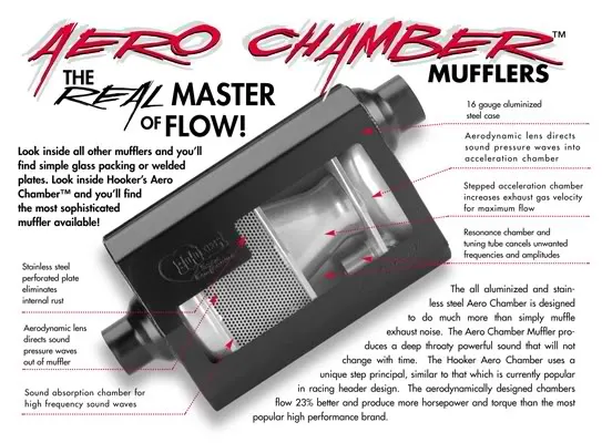

fwiw, i just picked up a set of Hooker Aero-Chambers. According to Hooker, they are quiter than Super Turbo's by about 3 decibles, and they flow 441cfm compared to 360 for the Dynomax Super Turbo's.
I have an off-road prochamber also and Im getting these welded in this week. I'll post some vids as soon as I can.
fwiw they do look like they flow very well.
