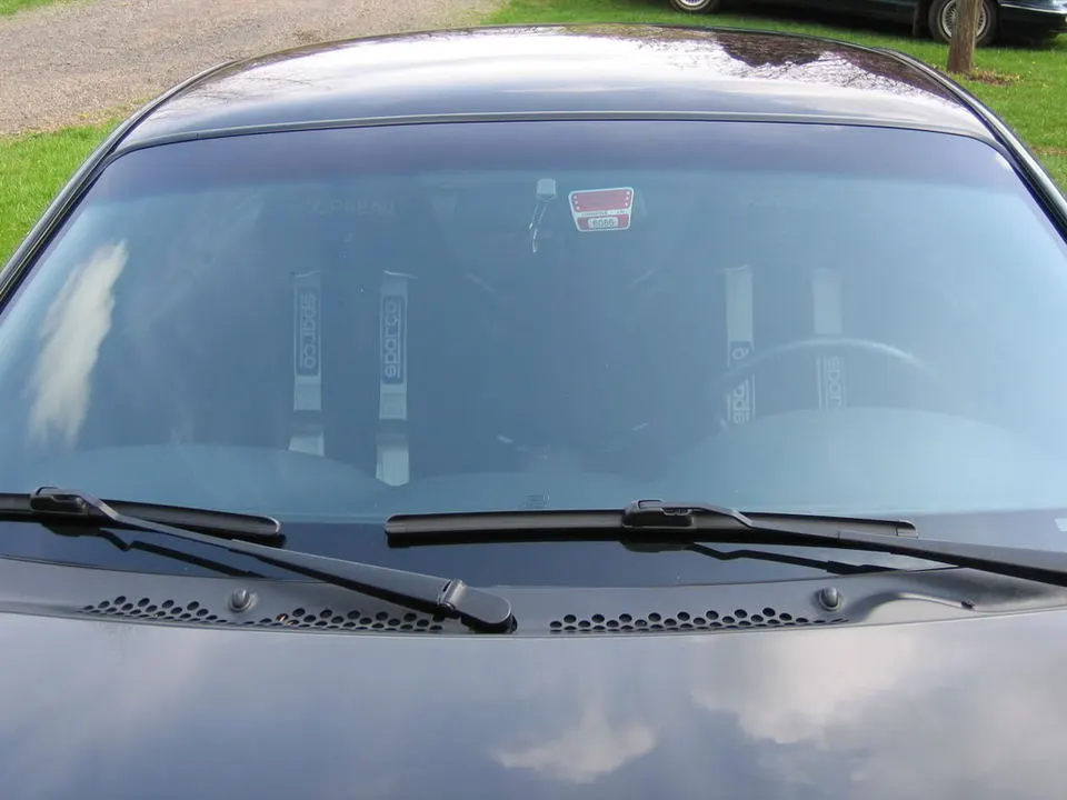

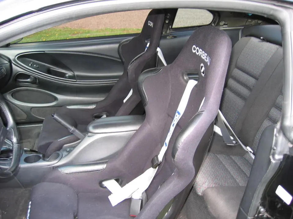

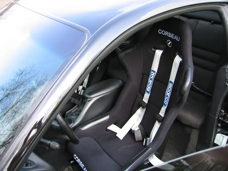

here are some picks. the harnesses are bolted to where the rear seatbelts bolted to the floor under the rear seat. I'm either gonna order a sparco harness bar or get a Steeda 4-point roll cage and weld on a bar for the harnesses.

not if its run through the seat right. It will compress the seat also, so it cancells it out. As long as the harness is level with your shoulders from the holes in the seat to your shoulders, you are good.
