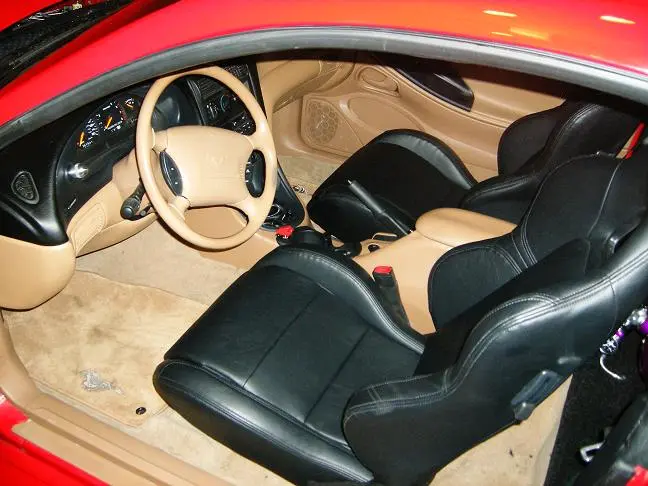

here is an older pic of the seats:
the power button isn't mounted...just pushed underneath the seat...I don't know if there is a way to mount that...you could try to fabricate something, but since the seat never really moves, I just left it pushed underneath...
I did exactly what 98stangV8 did. Used stock brackets and mounted them to aftermarket seats. The driver side was pretty easy but the passenger was more difficult. I would just spend the $200 to buy aftermarket brackets designed to fit next time.
Btw I had what looks like those exact seats in my old 98 and loved them.
