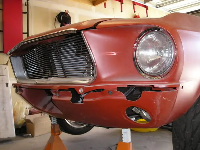

Here is mine. I was in the mock up phase at that point so there isn't a bumper on it. It may give you an idea though. I also have a billet grill that matches the grill that will go in there.

This is the one I was talking about, yes. Thank you, 68EFIvert.
I'd love to see the result from the front, once the bumper is set.
Also I like what you did with the headlight rings. I have stripped and polished mine as well; I just need to ship them out to the chrome shop for full effect...
