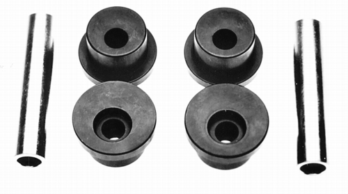

I see that MM has them, but there instructions involve the cutting of the factory bushing sleeve (they don't provide one with new bushings). Now Ford Racing has this set for $38
and it includes the sleeves (probably resized) so that no cutting is involved?? They also have an indexing feature to prevent rotation. Anyone have the FR bushings??
My son-in-law suggest getting the offset rack bushings (non-metalic) to help with aligning my car after new springs/shocks/camber plates. He says it's a bit more feasable fix to bump steer than the $200 kits.

Bugman.dave said:
I have the solid MM rack bushings, that coupled with a Flamming River steering shaft makes for some very tight steering.
It also moves your rack back a bit.
Those are nice. They appear to be non-offset aluminum. :shrug: Do you get the hamonic vibration noise with yours? I may still get a set, just non-offset. Did you have to cut the K-member bolt sleeve for yours?
No, no vibration and yes you have to cut the sleeves, but really it's no big deal,... very easy I found. Actually what I did was buy new ones just in case I screwwed up. Besides they are cheap and why not make it a totally new install. What I did find was I had to grind off a very poor weld on the K member behind the rack using a dremel tool. You want the back of the rack to fit flush against the K member. The bushings I purchased were non-offset.
