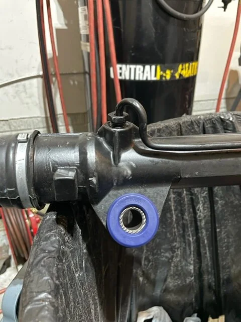

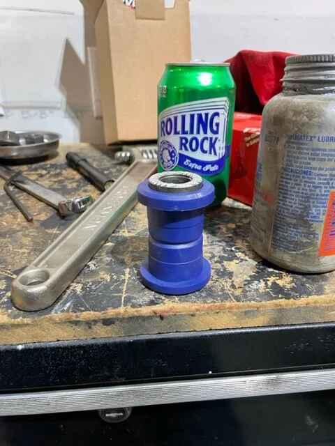

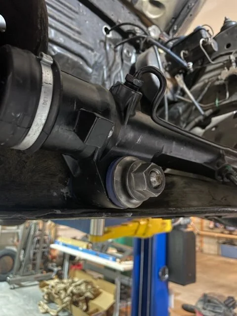

I wanted to follow up here with a simple solution I found....
I did find the correct bushings with sleeves to fit the '79-84 larger diameter bolts.
The new ones do not require pressing in, although I was not able to remove the old ones without a press.
These are a cheap Cardone option in urethane, PN 22-207MB. I got them 1-day delivered for ~$28.
Amazon product
View: https://www.amazon.com/dp/B007ETFS98?psc=1&ref=ppx_yo2ov_dt_b_product_details
Converting to the 1985 and later style is an option, but might not be necessary.
