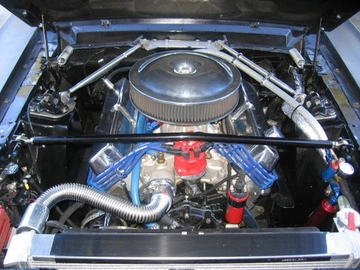

Hi. I am in the process of installing a northern aluminum radiator in my mustang and need a way to make my radiator hoses fit similar to the way adapters are used in this photo. does anyone kno how i would go about this and where to buy them?

Hey, that picture looks familiar :)

That's what I did too. Except I couldn't find one that was exactly what I needed.
That piece of chrome in the pic is actually a brass drain pipe I had from leftover plumbing under my kitchen sink. I used it to extend the hose. It's kinda like that on the bottom, but I have a Hose drain plug adapter pipe in there from Summit.
Just look through your local home store plumbing area!
