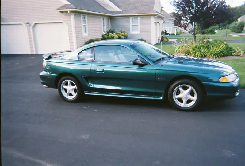

"Homemade" Shortened Stock Antenna Mast
I know the thread is old but hey... nobody has posted a photo of what a shortened antenna looks like. I cut my stock stainless mast down to 16" - peened the top of the mast - slipped a drop of epoxy on top - and forced the ball on. The mast's practical un-amplified length (as suggested by BullitAndy) is still strong.
Antenna base to the top of the mini stainless ball is now 16". It's not an 8-incher but even at 16" long it is still an inch or two lower than the roof line. Reception is right on and it looks much better to me... than the long stock mast.
Total cost: $0.00 :nice:
