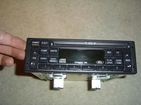

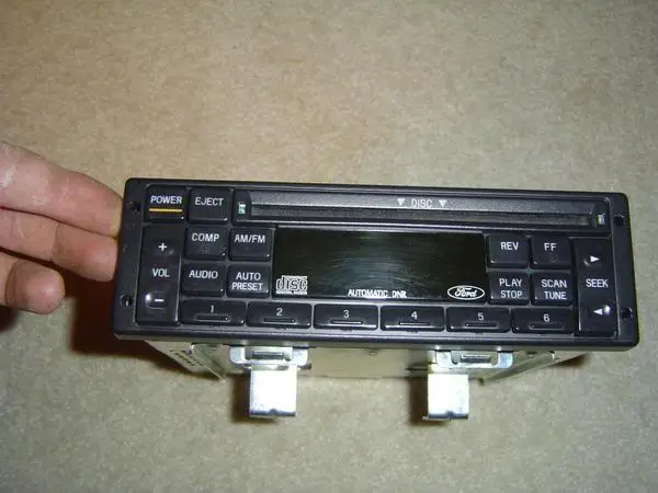

93 was the first year of the premium stereo package. It essentially incorporated an amplifier under the passenger seat. If you have premium sound in your mustang then a 94+ ford cd and/or tape from a premium sound vehicle will work without any problems. Also, there are two wiring harnesses attached by a clip in the very back of the stereo bracket. These were put in all cars, however, in the premium sound vehicles you can simply use these connectors rather than hacking up the premium sound (amp) cable if doing an after-market head unit.
And yes, the 1993 cobra could be purchased with an optional CD player.
Here is what the connections look like on the back of a premium sound radio for 93 (will also match other years with premium sound)
Lastly, when I got my Cobra the previous owner managed to put in a 94 Cobra radio with a lower slave CD player. They plugged right into the factory wiring and I don't believe he hacked up anything in doing it. I am still in the process of checking the wiring so don't quote me.
