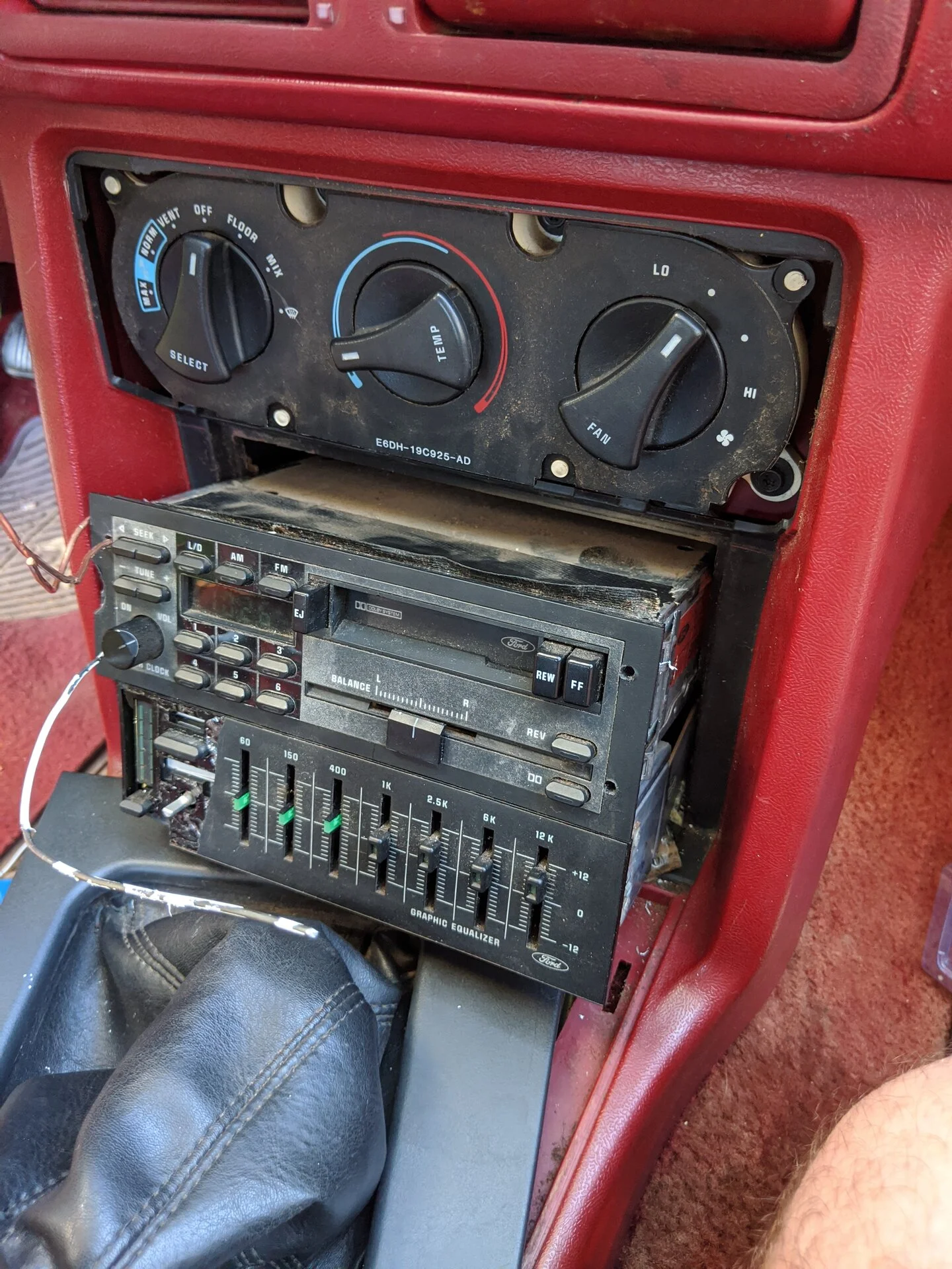

Hey guys I'm trying to pull the stock radio with the equalizer out of my 87 gt. I have gotten it loose but it won't pull out the rest of the way and I can't access the wire harness to unplug it... Is there some trick I'm missing? Thanks for any help!
Ok after cursing and drinking I found what I assume is some sort of grounding clip removed it and it slid right out so now I feel real stupid!
