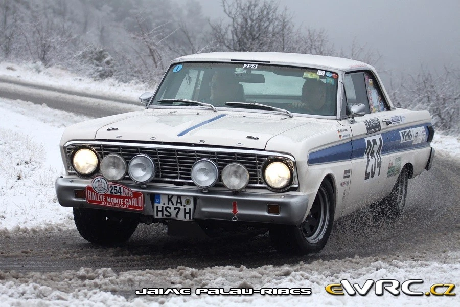

With that experience they build up two 64 Falcons for the rally in 1964 (here a picture of a clone):
They where successful in that year with a 3rd place.

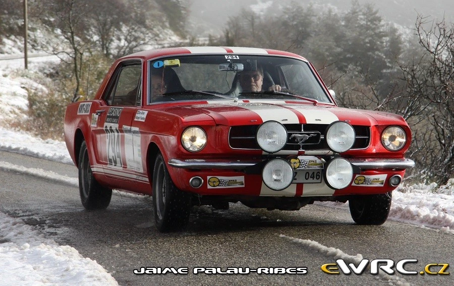

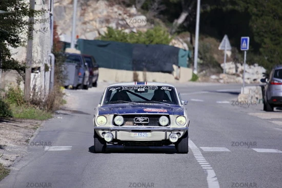

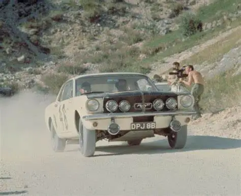

As for headights in the grill, do you mean like this:
mustang-104-jpg.46488

lights like in the first picture. But between the horse emblem and the turn signal lights. They should fit.
