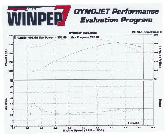

And than on Sat. I went and got a Dyno tune up in north Atlanta....
256.89 max power
285.07 max torque

maybe post a dyno sheet if your able to and someone more knowledgable can diagnose off that.
with those heads, cam, intake, and all your boltons, you should definately be making more then 250 at the wheels.

what was your a/f ratio on the dyno sheet?
heres my dyno run....
