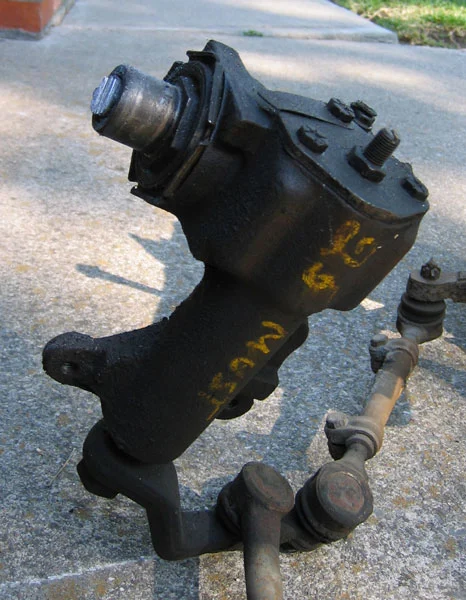

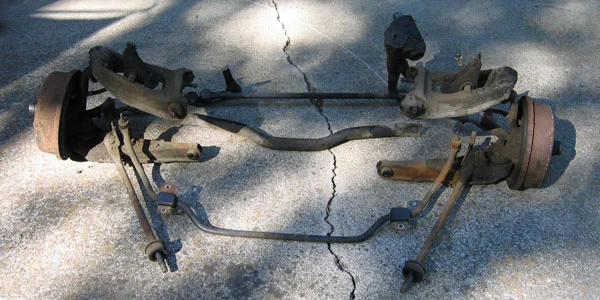

Completed steering column modifications today
Hey just wanted to note a couple of things for you:
1). The instructions don't say anything about the orientation of the flycuts on the steer shaft. This is a little thing, but...If you orient the fly cuts correctly the alignment mark at the steer wheel end will line up correctly with the dot on the steering wheel in the straight ahead position. When I was doing alignments, it was one of the things I would check and correct. In my case the fly cuts ended up being parallel to the indicator mark on the steer shaft. I also only needed to go back 3". Then I welded the collar to the shaft, and spot welded the coupler to the column tube. Used a chop saw for the column tube and for getting the correct length of the steer shaft. What an awesome tool.
Also it is suggested to have a machine shop fly cut the original shaft as this dimension is fairly critical (nneds to fit snuggly in double "D" coupler). If you are careful you can do it yourself. Again, I marked the shaft then used a hack saw. Kept it slightly to the large size and used the fine wheel of the grinder to carefully finish off the cuts. Took about 1/2 hour, and gave me some much needed upper body excersize. :cheers:
2). Picked up all new steer column to firewall seals, and a new turn signal switch as it is much easier to deal with while it's on the bench.
3). To facilitate a quick and easy dissassembly I removed the column then used a hack saw (a Sawsall would have been easier) to cut the shaft off at the box. My old box is in the garbage can. You may be able to get the sector gear cap bolt off, I couldn't. This kept me from having to disconnect the ptiman arm, or drag link, and farting around trying to get the whole box and shaft out as one piece. In fact since I'm replacing the entire front suspension system, I was able to drop the whole thing out, including the sway bar as one assembly. Took a little less than 2 hours, including the column. Then with the old front end out in the driveway I undid the sway bar end links and the tie rods to make everything small enough to fit in the garbage can.
HTH,
Scott
