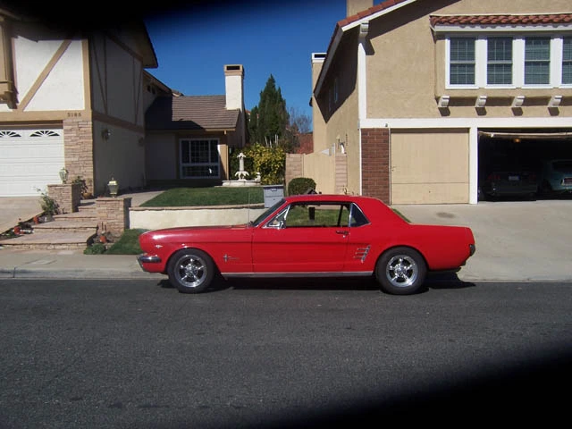

First, I am wondering if my springs are sagging, primarily so i have a feel for where it'll be with new coils. I saw Marlon from Fly Fords in Chatsworth a few weeks ago and he was surprised my stock springs (stock height/spring rate) were so low, even taking into consideration I have done the Shelby drop and have a 351w. The springs are about 10 years old (though they only have maybe 10k miles on them, still getting up there I guess). See pic below. Note that I have larger tires in the rear… 225 60r15 vs. 225 50r15 (had to switch to 50s in front because of rubbing)... also the street is slightly inclined up towards the front of the car.

anyone have any comments re: whether those front springs are sagging or not?
it would definitely help with my mental image of how the car will end up if I know whether its lower than it should be right now
here's the pic again, and those are supposed to be stock height springs up front (with 50 heigh tires in front as opposed to 60s in the back... this might account for some of the 'sagging')
