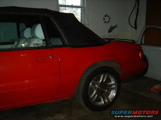

I did this to my '86 vert today, and noticed as I bolted my wheels on that the little hub things on the Ranger axles are smaller than the hubs up front on the SN95 spindles I've got. Basically the hub doesn't fit snugly into the center hole on the wheel, even though the lug pattern matches. Anybody else notice this? What are the chances of it causing a vibration of something? Is there a spacer I can get?
