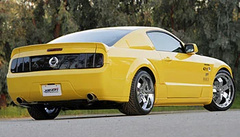

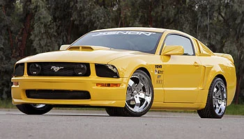

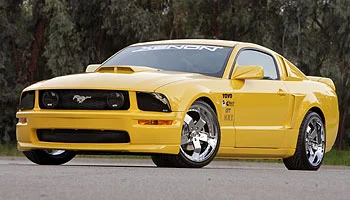

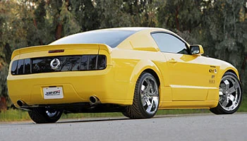

Infinity said:
Niche f-18's look VERY close to those and will fit properly.
http://www.mhtwheels.com/wheel.cfm?brand=5&cat=93
