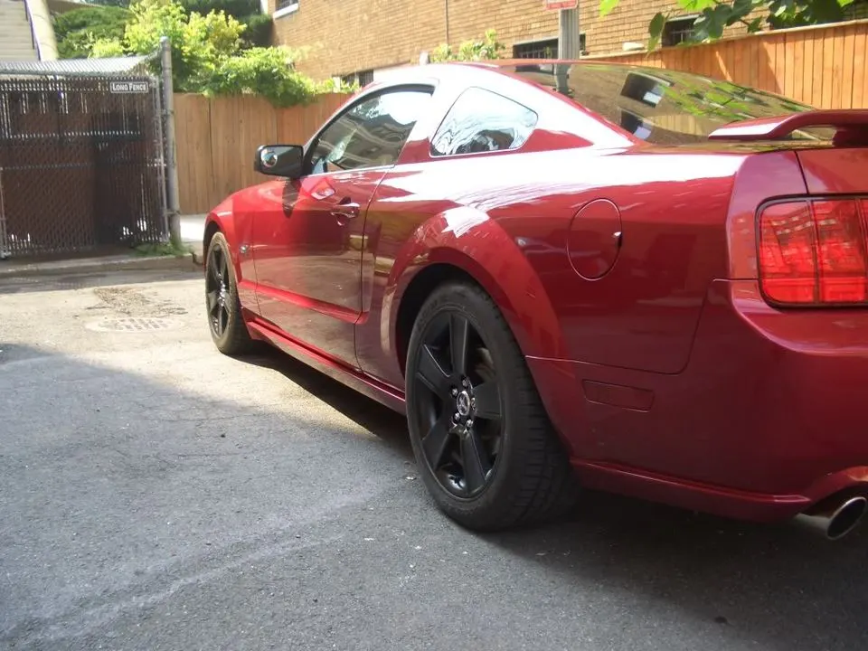

Hello All,
Well I'm prepared for the deluge of criticism, but I've got a question for you.
I sanded and spray painted my fanblades. I didn't like the fanblades and just wanted a set of wheels to use at the track [road courses not drag racing]. It worked just fine.
Now I'm trying to sell the car and the wheels are one of the things standing in the way.
Anybody know if I can just remove the spray paint with [fill in the blank with your favorite paint remover] and re-clearcoat the wheels? I did not sand very deeply and am hoping I only 'scuffed' the original clearcoat, so a new clear coat might do the trick, yes?! no?!
Thanks in advance for any assistance!
JD

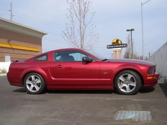

as it is now:
as it was originally:

I have done the exact same thing before. It took some "Mineral Spirits", and ALOT of elbow grease to remove the paint/primer ( I did both to mine). After I removed the paint/primer, I shot a little clear on the wheel to see if the "scuffs" would show through and indeed they did. I then "wet sanded" the wheel (probably not the best thing, but it worked), and applied two or three coats of clear via a spray gun. The end result was about 85-90% good as new. The only way one could tell that there was something awry was to match them up against another Saleen rim. Hope this helps.
IMO, the painted fan blade looks better than the stock one. Good luck man!
