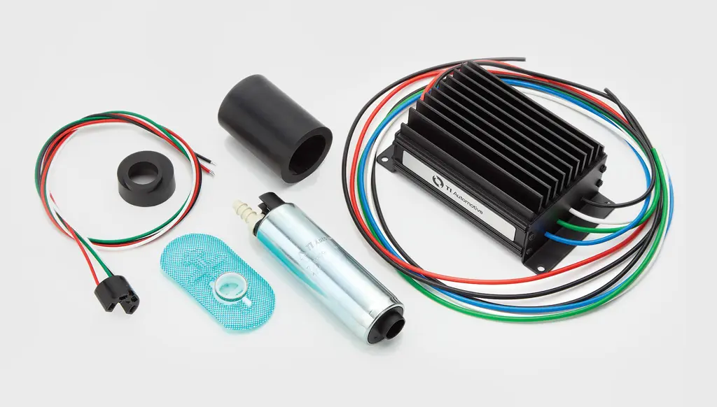

Well I don't think anyone would sink a brushed motor that sparks on the rotor in a tank of gasoline. A motor can be brushless and two wire if the control is in the motor. And that is what I suspect is burning out in these. Just don't know how or why. If I go in the output tube of the in tank pump I can turn the impellor a little with tweesers and when I put 12V on it it will turn just a little like it burnt out one of the pole driver. I will cut the last one open and make sure.
Looking forward to images of your brushless in-tank pump complete with ESC and heat sink.
This one, for example, runs for about $1700 online:
This one has an external controller for a retrofit (like on our cars if we decided to add one).
